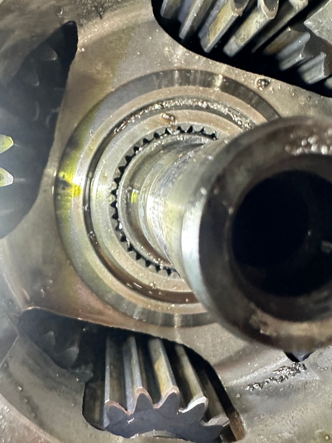

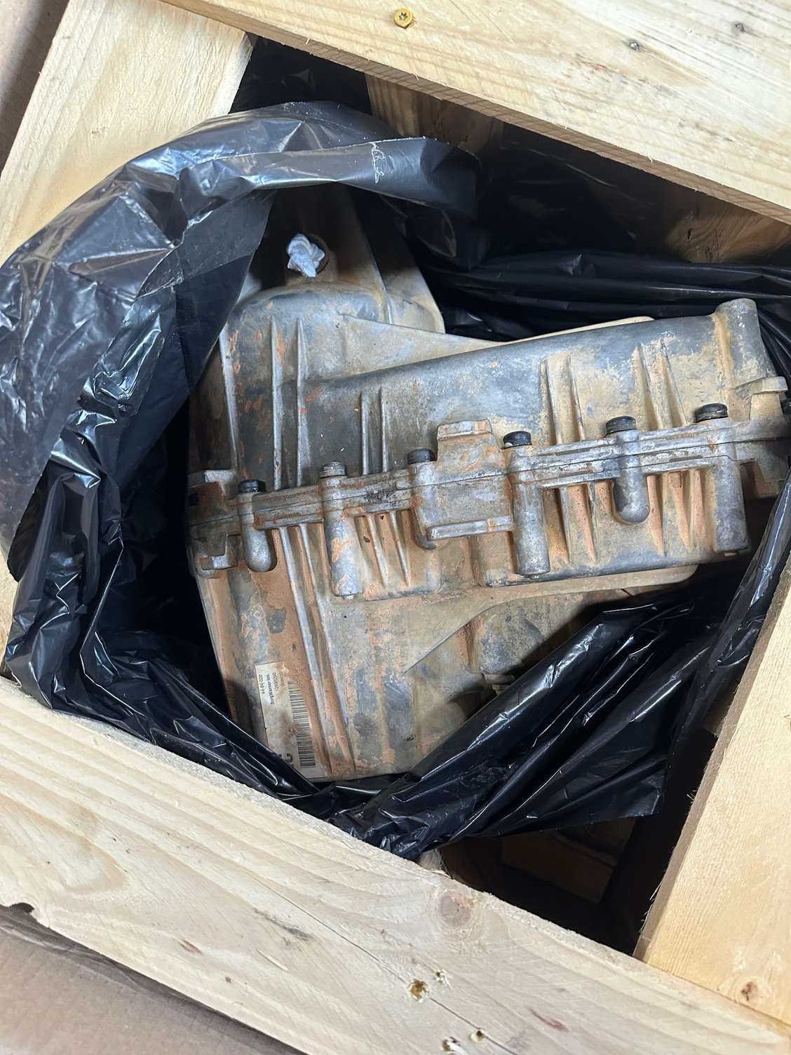

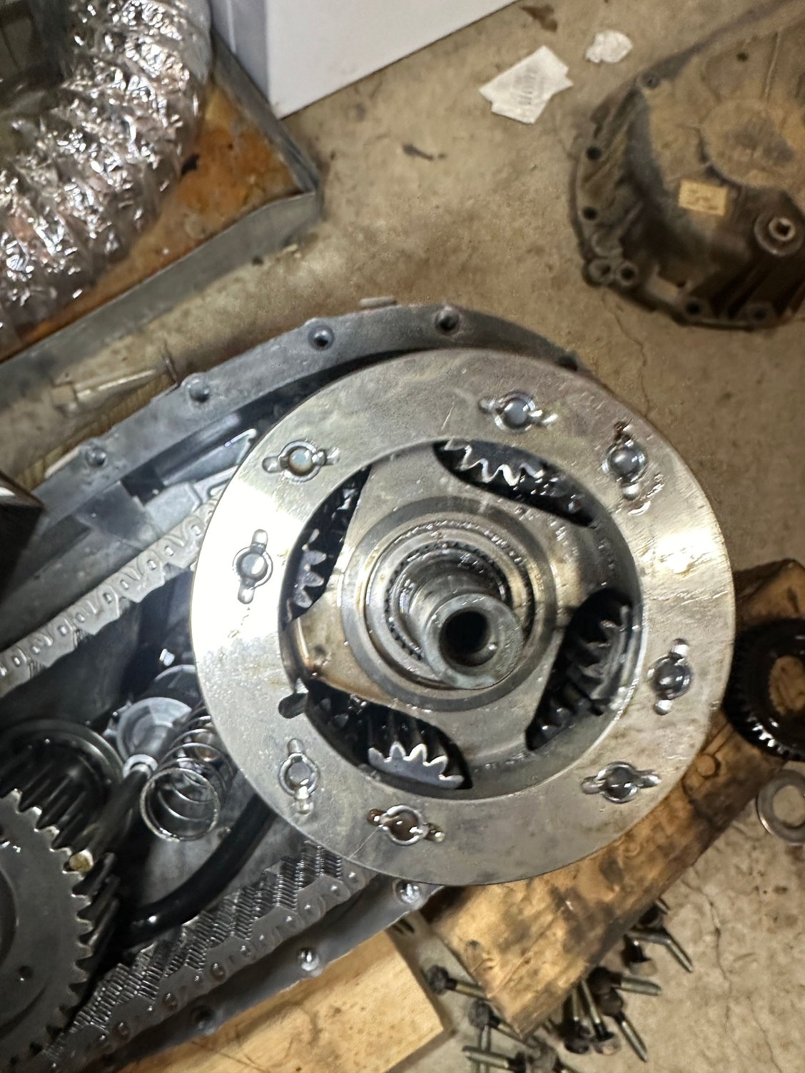

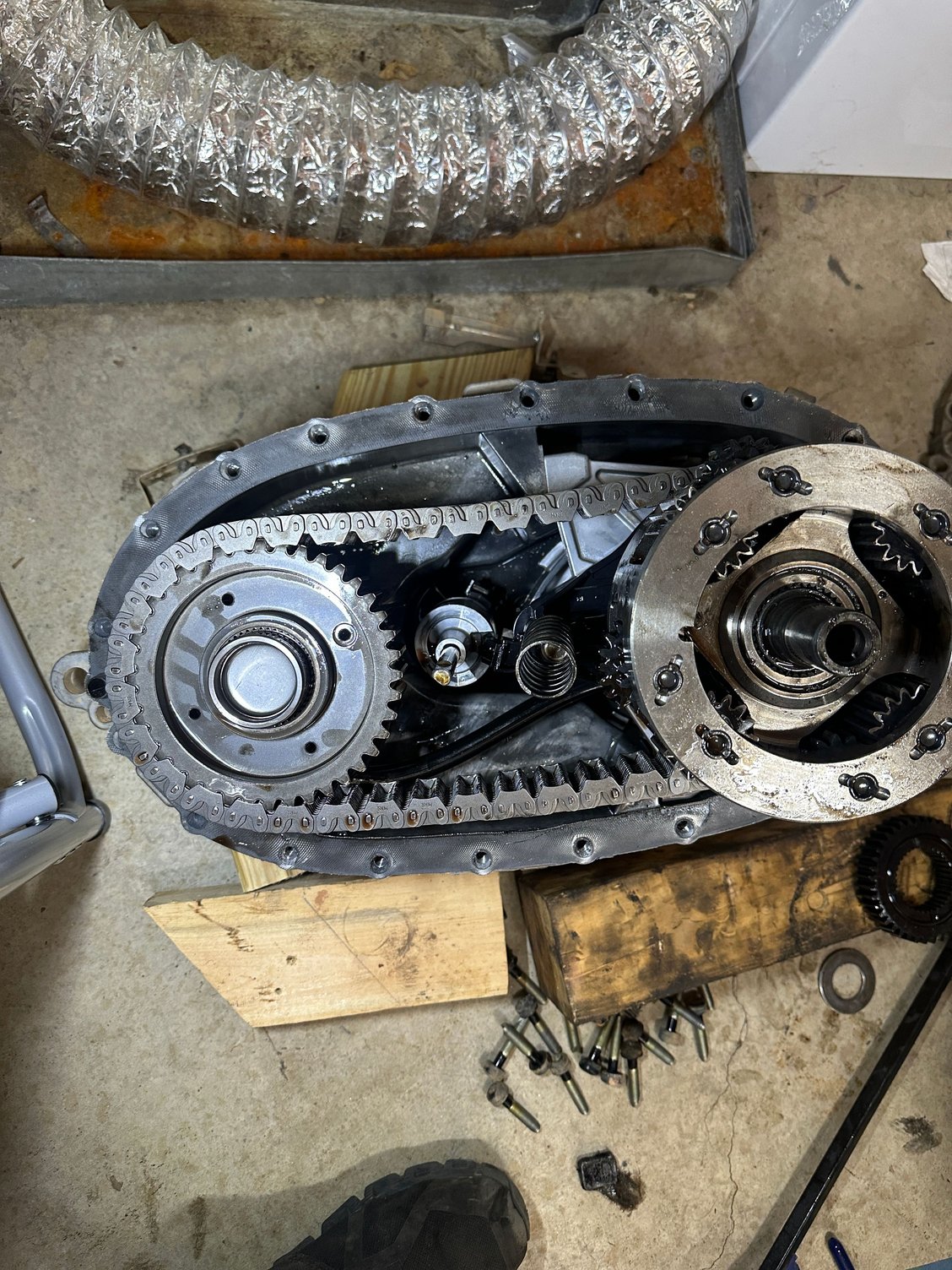

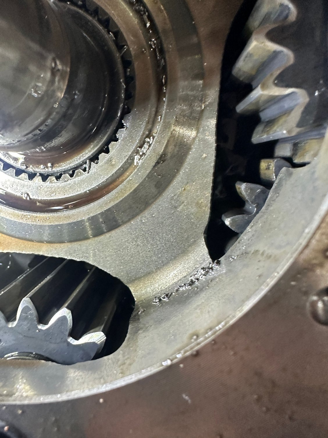

Figured I’d offer this up here first before returning it for a core. Out of my 2008. Broke it trying to do a burn out with the front driveshaft out. Only has front wheel drive now. Looks like it sheared the splines off of the shaft that goes into the rear planetary carrier.
This is the 32 spline version that can be mated to a 6l80 or 4l80. Not the 4l65 in the 03-07 years. This is 2008 only. Remanufactured, the 32 spline variant can be upwards of $4000 and are very hard to come by.
asking $600 pm me.

It’s a good thing it happened honestly. Shows that these full time transfer cases actually are weaker in that they can’t support 100% load on only one side. Glad it happened close to home than out on a trail in the middle of nowhere. Swapped to an np236hd part time case and now I do all the burnouts I want!
