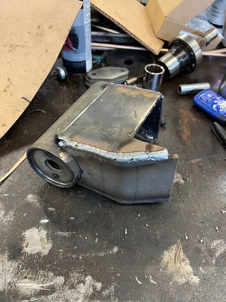

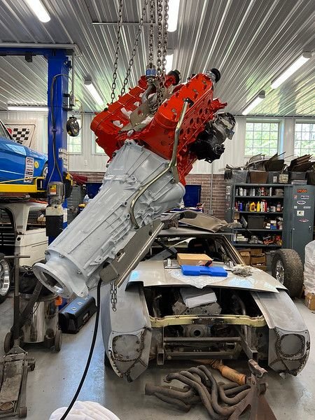

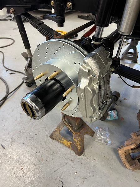

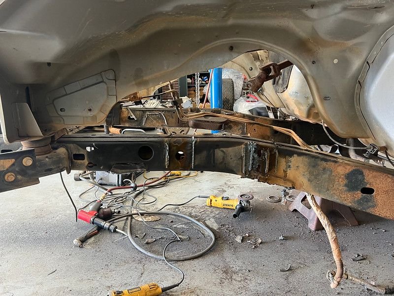

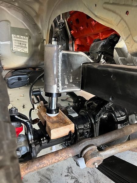

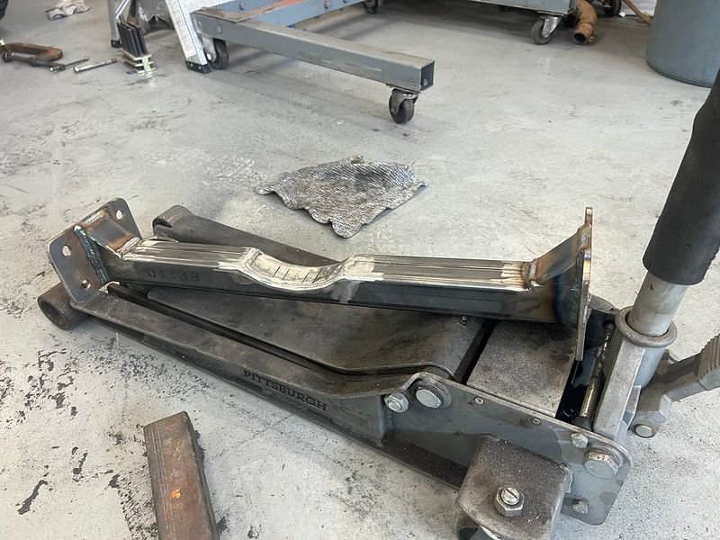

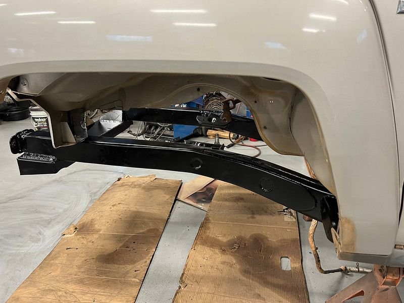

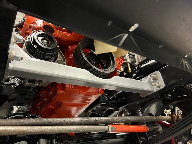

Bought a cheap 2008 Alpha that was completely spent. Decided to replace almost everything, I never liked the straight axle conversions because they sit too high. I really didn't like working on the truck because the front suspension made it miserable to work on the starter, A/C etc, that suspension stuff was in the way of everything. The transfer case was a bit of a nightmare as well in my opinion. Here is how I went about changing it.

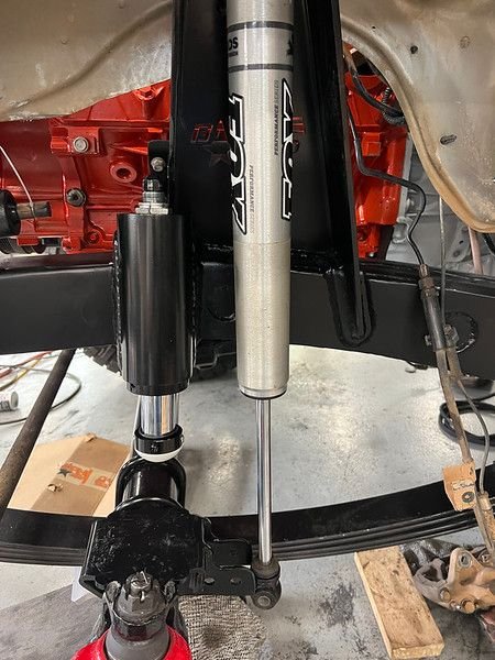

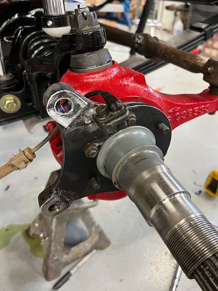

I leaf sprung the front Dana 44, which wasn't easy because I wanted it low, and still have 9" or so of travel

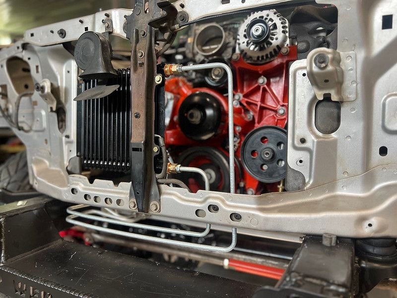

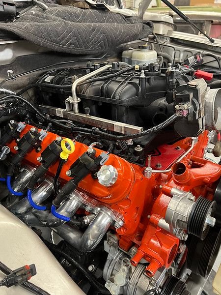

I installed a 5.7 LS6 out of a Corvette, forged pistons, H beam rods with a Truck Norris cam
Installed a 6L90E with a 2700 convertor
I installed a Dana 300 transfer case with twin sticks

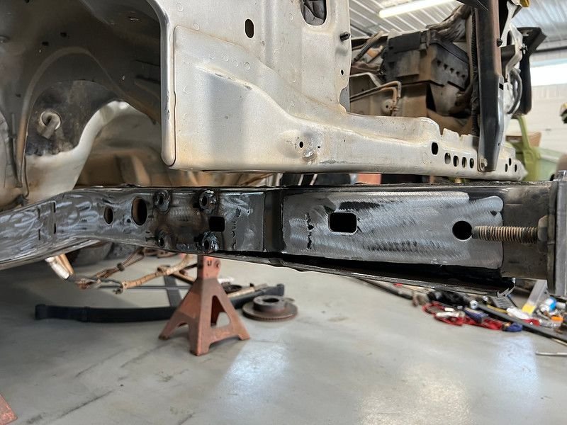

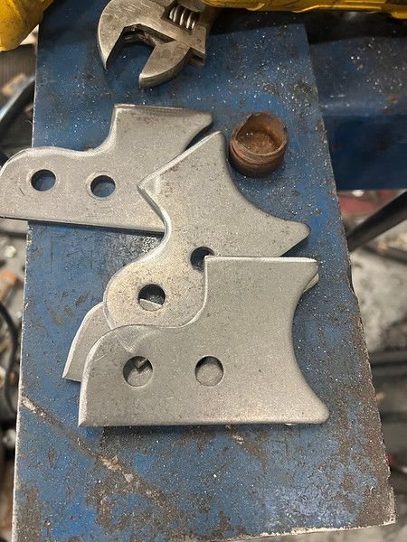

Modified the frame to beef up the front where the leaf spring mounts go

Seems like most SAS's these day go with links, is there a reason you like springs better?
I've also been curious about using the more modern 8 and 10 speed autos and how they would mate to older style transfer cases.

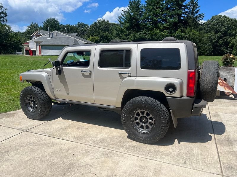

The under-sprung leaf springs were done specifically to keep the height down. I like the link suspensions, just don't like where the ride height lands. In doing the conversion absolute see why the altitude ends up so high, there is not a lot of real estate to put all that needs to go there. It wasn't easy getting it there, but pretty happy with the stance. This truck ended up with 5" of compression, the last 2 1/2" are slow with a hydraulic bump stop, and 4" of droop. The rear has no lift, the front is just leveled more or less

I hear you. It looks pretty close to stock height.
