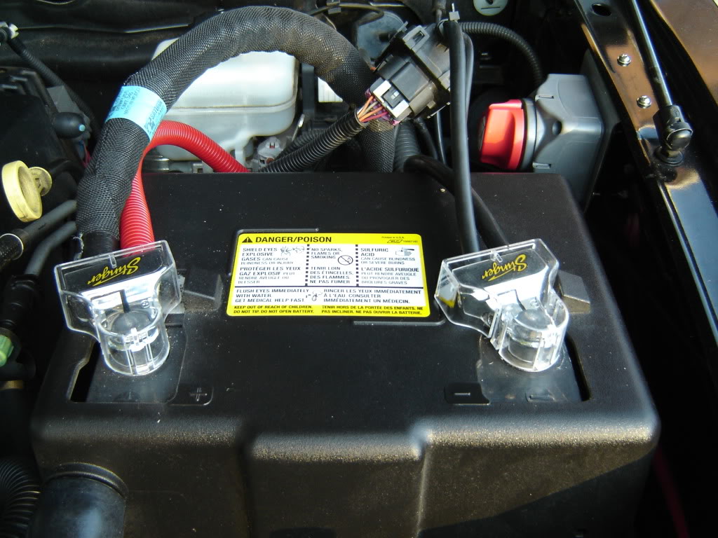

I was trying to determine which TCCM you have by asking the simplest question I could think of, and by your answers (08 I5 no locker) I would now doubt that is your issue.
Check if your truck will smoothly shift from Hi, Hi Lock & drive it a short distance, and Low Lock & drive it a very short distance like 30 meters, then back to high lock? If it will shift into low lock and back to high lock with no glitches your TC actuator is likely not be the problem. The TC actuator is an electric switch motor that shifts the Transfer Case, they do go bad occasionally and can throw the message in the DIC that you have, but like I said, many things can cause your problem.
So if it were me and trying avoid a trip to the dealer, I would start with the easy things first, like adding good quality battery terminals.
You will probably have to take it to an authorized service dealer but we are trying to help.
