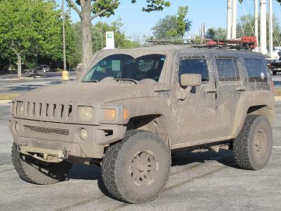

ya, my duratracs were slinging mud very easily when i went to the Pine Barrens last weekend
Attached Thumbnails Tires Sticking Out-48325p893475p983475p93475p938475p93475.jpg

do you have any lift on your h3 it looks great,i think i just changed my mind from a 20" rim to something smaller,it looks strong,i work with a piney where in the pines do u live
I agree. I personally didn't want anything bigger than an 18 and just ended up getting aftermarket 16's with a lower offset. I love the stance it gives my Hummer. Looks tough!

no, that is the stock suspension with the tbars adjusted 2in. i actually live in delaware and go up to the pine barrens every month
