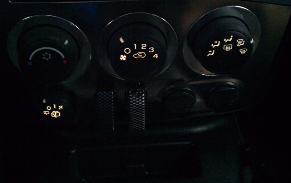

I gave up and fitted a couple of Autozone covered toggles. Quick and easy install.

Looks pretty good too.

those look sweet! Looks like the perfect switch for the electric fan manual override, and maybe for some new lighting too!

Looks nice (carbon fiber look )

Nitrousvert,
How did you get around the integrated plastic clips at the back of the panel you mounted the switches to?
Was it Dremel time?

Thanks guys. For 10 bucks each off the rack I’m pretty happy with them. One is for my Daylighters up front, the other is a manual switch to turn on the reverse lights. Always helps to have a little extra light out back.
As for the plastic clips holding in the button blanks, my first instinct was to reach for the Dremal too. But they can get away from you and scar things up from time to time. So for more control I used a utility knife blade held in a small pair of vise-grips. I heated the blade with a propane torch and used it as a hot knife. They came right off nice and clean with very little pressure on the blade.
A manual electric fan switch is used to operate the fan when the vehicle engine is shut off. This allows you to cool the fluid in the radiator without adding any additional heat. I have this setup in my Mustang to cool the system while waiting in the staging lanes between rounds. It can be a useful tool in many situations.
