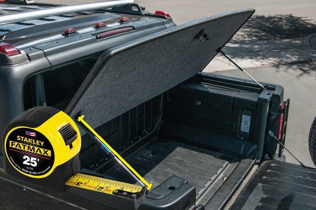

Hi everyone, i just joined and I have a 2006 Hummer SUT. Just love it already I have had it for 3 weeks now. My question is I think the lift supports for the Tonneau cover were not the correct ones that are on it. I did buy some from Amazon but they are to week. I bought another pair, and it practically lifts the cover up so fast it would have hit the back of the cab had I not held on for dear life.
Can someone help me with a part number for the correct ones or guide me to where I could buy the right ones.

Do you own a tape measure? Check compressed length & extended length. Then figure in the amount of force you want:>>>>> Lift Struts by Size
