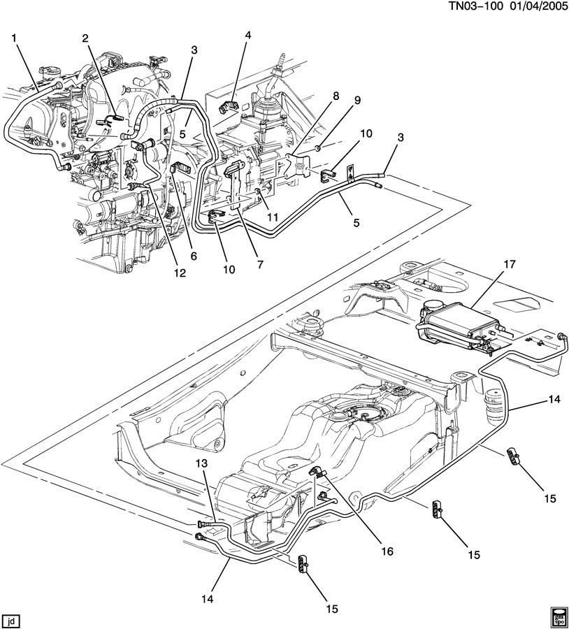

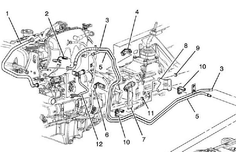

HummerZ pic shows a black line going into the side of the TB. That is where I've done it b4. Also, a great spot to put in whole system cleaner. After the MAF.

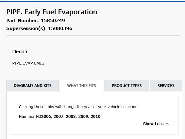

15850249 (#12) connects evap line to the purge valve.

well it seems the guy who owned it before must of used a different line there, he took out the one with the green cap and just put one with a 90 bend on each end. no idea what vehicle he got it from, going to see if i can buy just that line or if i have to buy the whole. thanks for all the help
