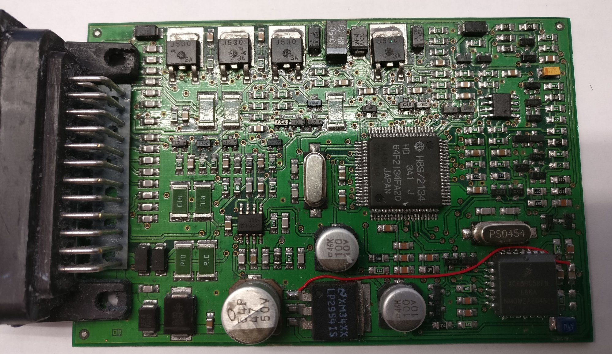

To check the comms, unplug one of the ride-height sensors, eventually you should see a "Service Air Suspension", if not then it suggests the battery was reconnected without comms to the AS unit so the BCU thinks the AS is not there. If you've never seen a "Service Air Suspension" that in itself suggests there's a break in the comms circuit.
Hopefully your new module will do the trick, which means you've been very unlucky with the modules, however if that too doesn't work then it must be the wiring.
Oddly enough my module died with exactlty that problem, after repairing it I found there was a bad PCB track which could be a common problem but unlikely (my module was GM P/No: 10363984)
See JPGs for those who have never seen an AS module PCB before, the red wire fixed the broken track (trace) which was in fact the +12V power to the comms chip. Unfortunately this repair job is not easy as the module is potted in rubber and so probably not achievable at home.
