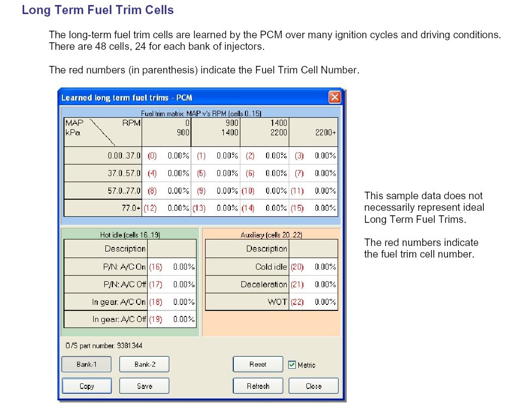

Resetting the computer by disconnecting the battery is usually recommended when installing a new intake as it resets the short and long term fuel trims back to zero and gives a better chance of not setting a CEL. Generally, your trims are not going to be perfect when you do install a new intake and the values that are there may throw you in error enough to throw a CEL before the PCM has had a chance to relearn the new air flow and compensate. Here's a page from my tuning sw user manual that shows the fuel trim table as it appears when it's zeroed out which is optimal. The zeroes indicate no trim adjustments are necessary and the fuel flow rate is set where it needs to be. You will never see this in real life since there is no such thing as an engine that runs perfectly in every RPM range and mode. Zero is the goal. (Note: This table is for a V8 LS1/6 so there are two banks of cylinders, etc.)
So, you did the right thing disconnecting the battery to reset the trims and let the PCM relearn the new air flow. You'll need to drive around a while to let this happen. If you set another CEL, I would start looking for anolmalies in the air tract or some other issue. The fact that the CEL went out indicates the MAF sensor is most likely not damaged so I would look for restrictions in throttle plate movement or leaks causing unmetered air to enter the engine. Also, get a buddy to help so you can look and listen to the engine with the hood up while he/she runs the engine so you can be right at the engine to look or listen for problems.
