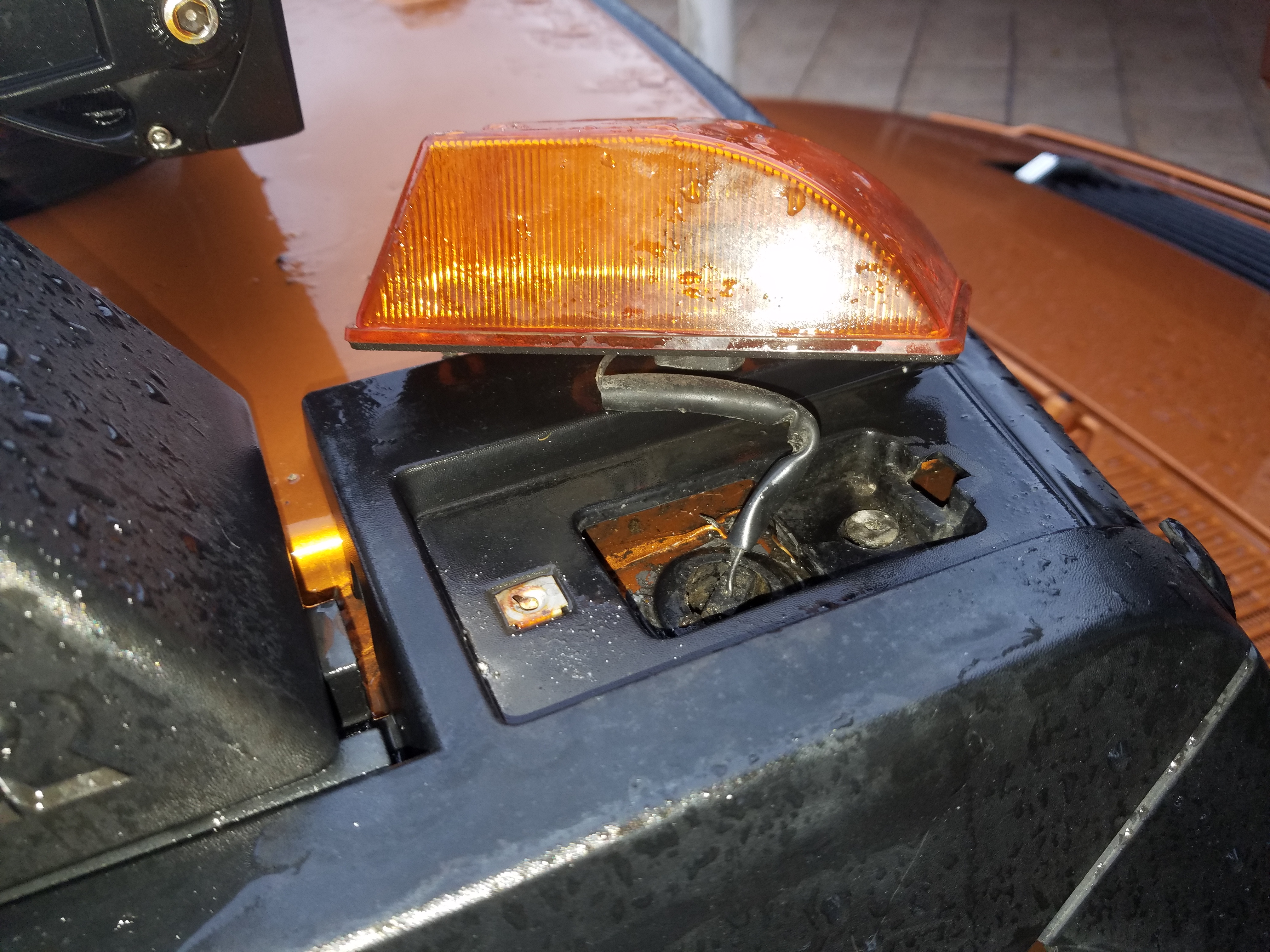

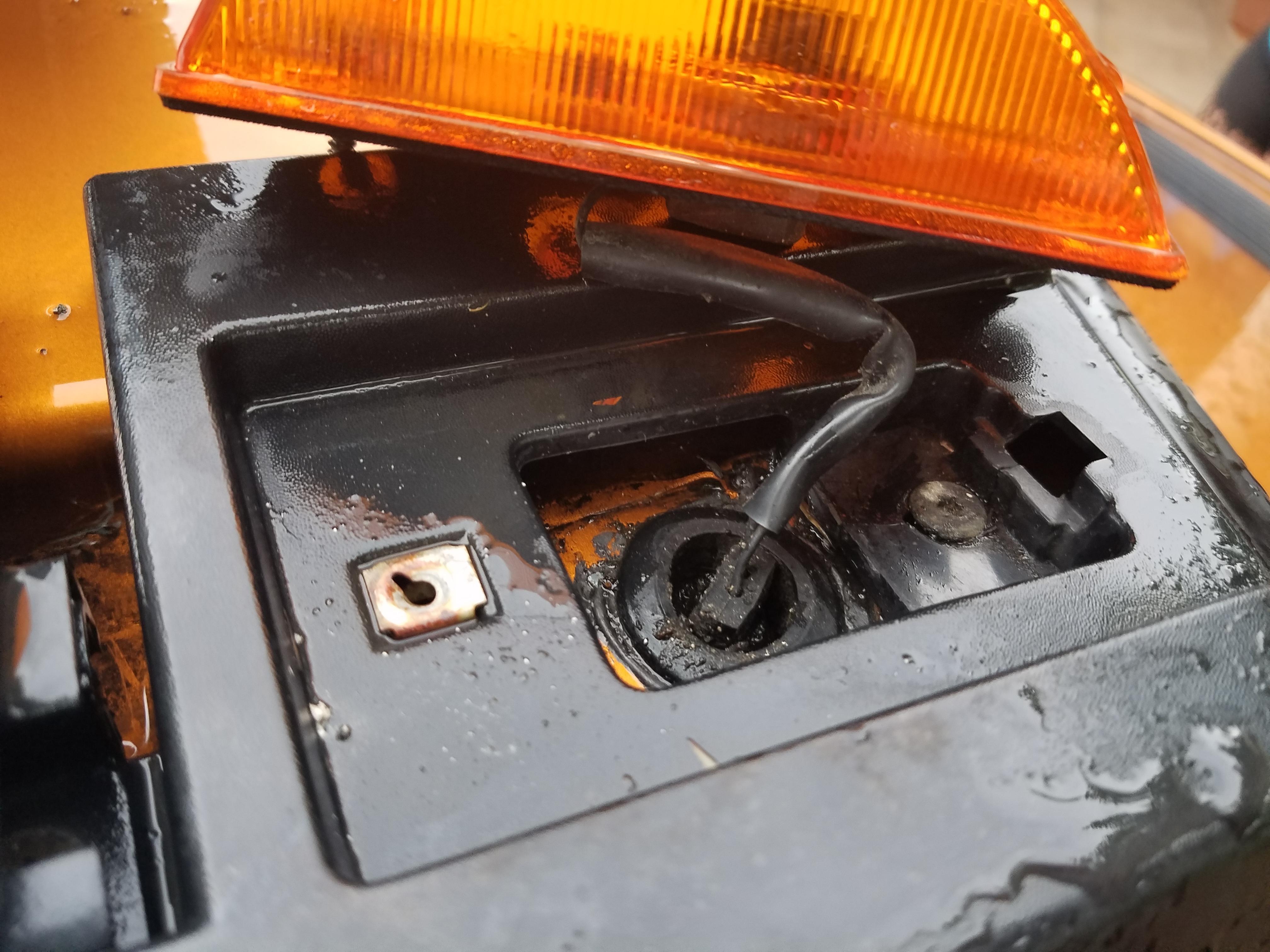

First contact your local dealer . They can get you the oem seals but removing the lamps and a silicone will do the work
Also when you remove the lamp cover you'll see a plug with a rubber grommet I covered the grommet inside with the silicone
Check the pics . That was before the silicone
Attachment 10072
Attachment 10073
That's great! Pics really help too. It was such a strange leak, glad for the easy fix.
