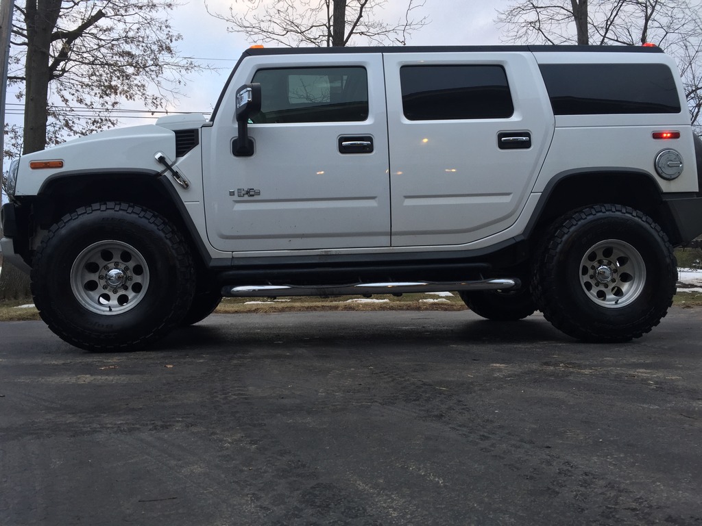

Here's my 08 on 37x12.50x16.5" with about a turn of the torsion bolts,
I need to do another turn or two yet to level the front out.
My control arms are all original so i'm sure they are worn out, and I have replacements waiting to go in.
With that being said I get a tiny bit of rubbing at full lock which I am confident will go away with the new arms, and especially with a tiny bit more front lift.
Tires with the weight of the hummer measure 36.3", and were 36.5" with zero weight on them.
Hope this helps...Name:  Daily%20H2_zpsgfn0zryq.jpg

thats a beast, great looking truck. im happy now i will pick 37/12.5/17 will look good. at beginning of post some owners say stock height would be ok to accommodate 37/12.5 just crank torsion keys. and rubbing is minimal
are those Toyo MT ?
