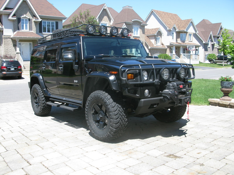

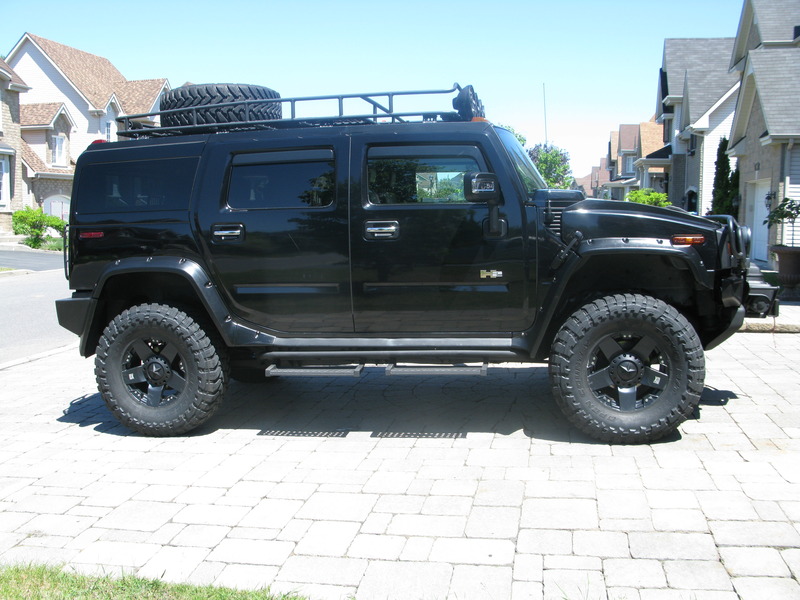

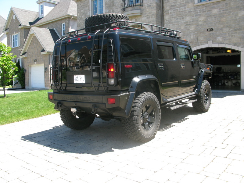

38x13.50x18...Info on my signature, regearing to 4.88 soon.
