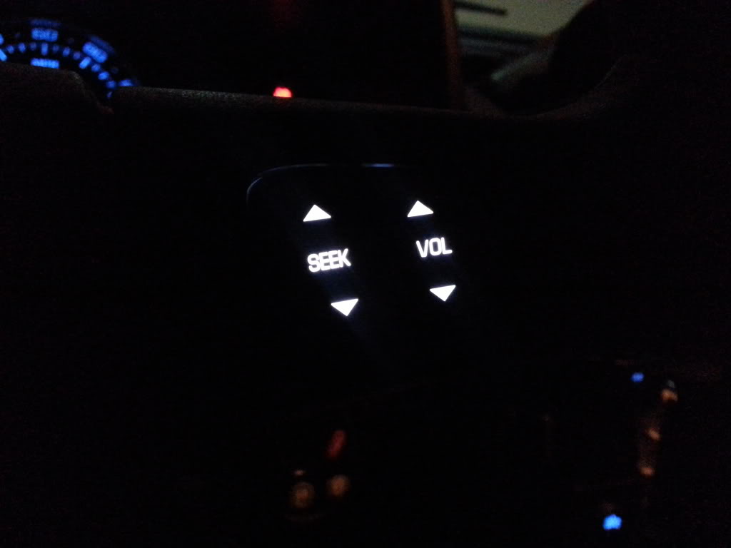

Here's a pic of white LED's. You can see its a very crisp white, much whiter than the dull yellow stock bulbs.
