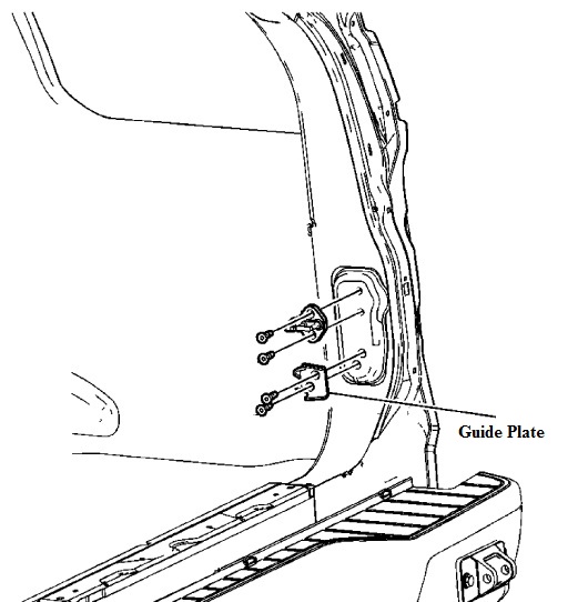

Try a little WD40 on the guide plate for the endgate. The contact between the metal and rubber may be causing your squeak over uneven terrain.
