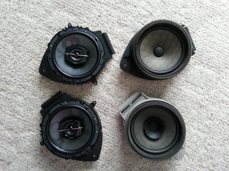

I had the same thing happen to me. At first I lost driver side front and rear. Next was the passenger rear. I assumed it was the stock head unit (didn't do much research on the subject) so I ordered a new Pioneer DVD head unit. I wanted a new system anyways to be frank. Bluetooth and I-pod interface was a must have. Love this new system! $270 from Crutchfield. Hooked it up and same deal, one speaker working. I had never heard of multiple stock speakers going in such a short period of time simultaneously. Ordered a new set of Sony XS-GT1638F 6 1/2" 3 way speakers from Crutchfield for $99. 4 speakers, mounting plates and factory connections included. And free shipping. Problem solved. They are quite an improvement over stock speakers.
