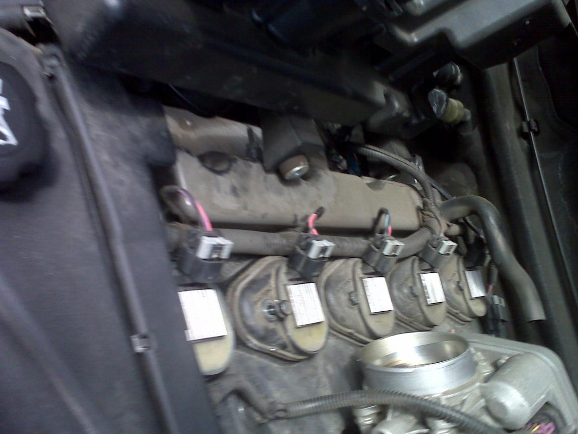

Guys, when I was looking, I didn't have much luck finding instructions, so I thought I'd document it when I did mine and help someone else. See my photo gallery for descriptions on each photo of what I am going describe.
First off, it's a very easy change with 2 things to look out for. One, make sure that when you do get the old plugs out that you compare the overall length to the new ones. I had originally bought Densos specified for my vehicle and they could have potentially caused a misfire because they are about an 1/8" shorter. With the Delphi ignition modules that control the plugs, contact is made by a spring, similar to a flashlight battery. There was no spring load when I replaced the first one which set off a red flag to me. I checked and the shorter length was the cause. I ended up using AC Delco iridiums OEM equivalent (111K on the 1st set, I'm not complaining).
Second item is on the front most cylinder, the wireway on the wiring harness has to be moved out of the way to remove the module. This is done by removing the snap on cover from the wireway. Removing the passenger side fastener holding it down is enough to access the module. Use a flat blade screw driver to rotate the plastic fastner down through the slot below it like a screw thread.
That being said, the change is pretty simple.
Remove the 2 screws holding intake plenum down on the passenger side. They are 10mm hexheads. Next, loosen the 4 hose clamps holding the air filter hose and intake supply hoses in place. I removed both hoses to make it easier and allow me to clean, but this could be optional. The plenum is then loose and can be lifted off. There is a drainback hose in the rear on a ****** fitting, but it pulls right off. Just make sure to replace it during reinstall.
Now the 5 ignition modules are visible. They are each held in place with a 10 mm hex head (I guess someone at GM was thinking, because the tools required are minimal). Once the bolts are loose the module slides straight up and the boot comes off of the spark plug. Things at this point look familiar. Gap, anti-seize and replace the plugs and replace the parts in reverse.
Please do remember to check the plug length. I read about one guy having misfires after changing his plugs and I fear the length is the reason. Good luck.

What type of spark plug did you use? OEM?
Old May 11, 2009 | 07:50 AM
AnthonyZ's Avatar
Joined: May 2009
From: Houston, Texas
Default Spark plugs used
I apologize. I'm an engineer and use terms that I assume everyone else knows. OEM is a term for original manufacture parts. The spark plugs I ended up using were AC Delco 41-103 iridium. They are the 'newer' version of what was stock from what I can tell. Dimensionally they are identical. Gap them to .043.
