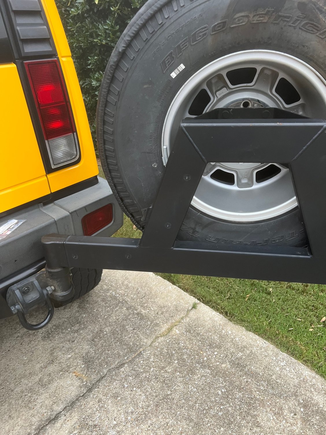

When I bought my H2, the previous owner had taken the spare tire and mount off. He gave it to me when I bought the vehicle and I’ve since reinstalled it. I didn’t even think about the license plate light until I got pulled over for not having one. I bought a generic light off Amazon. Is there a plug or harness I can tap into?

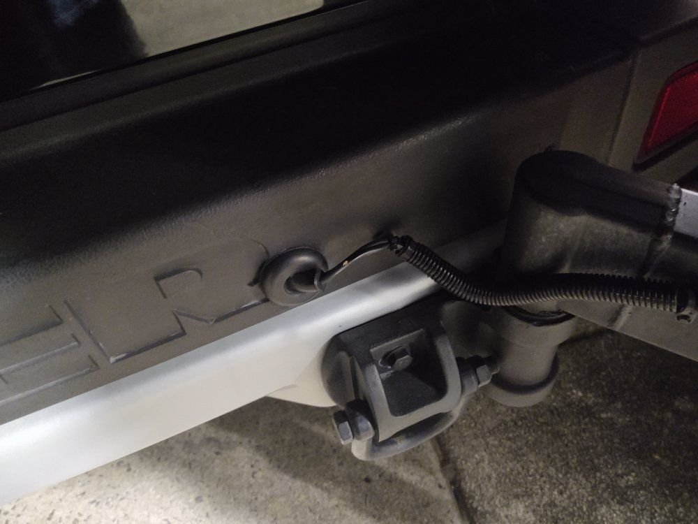

The harness runs through that hole in your bumper cover, I just looked at mine and found a part number on the harness, maybe it will help. 15246319A harness asm rr lic plt lp wiring is what the tag on it reads.

and yes, harness is missing. Look behind rear bumper. If the guy was smart at all, he bundled and strapped it under there. But I doubt he was smart, as evidenced by the gaping hole in the bumper.

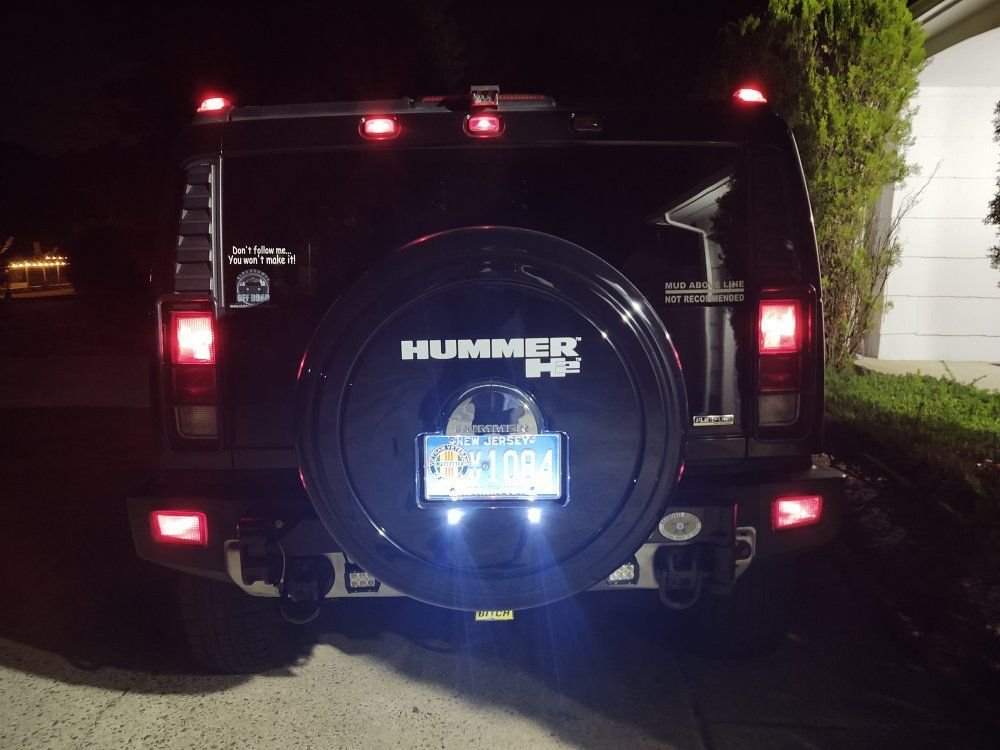

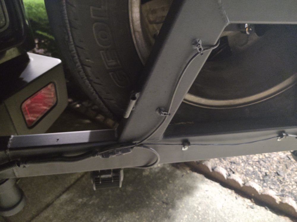

I have an 2009 H2. I guess yours is either a 08 0r 09. That hole is where the special grommet plugs in. There is a hole in the grommet for the lead wire to pass thru and up the back side of the square tube carrier. Those 4 divot's you see on the back side carrier are where a wire holder plugs in. The lead wire passes thru the holders into the rear and to the holder that the tire sits on which contains the bulb housing and socket.
Not sure where power comes. from. You'd have to look that up in the shop manual. I bought some aftermarket L.ED. plate lights and tapped into the normal feed.
The other wires you see coming off of that main wire feed are Back Up L.E.D. Lamps I added which are under the tire carrier buttom.
