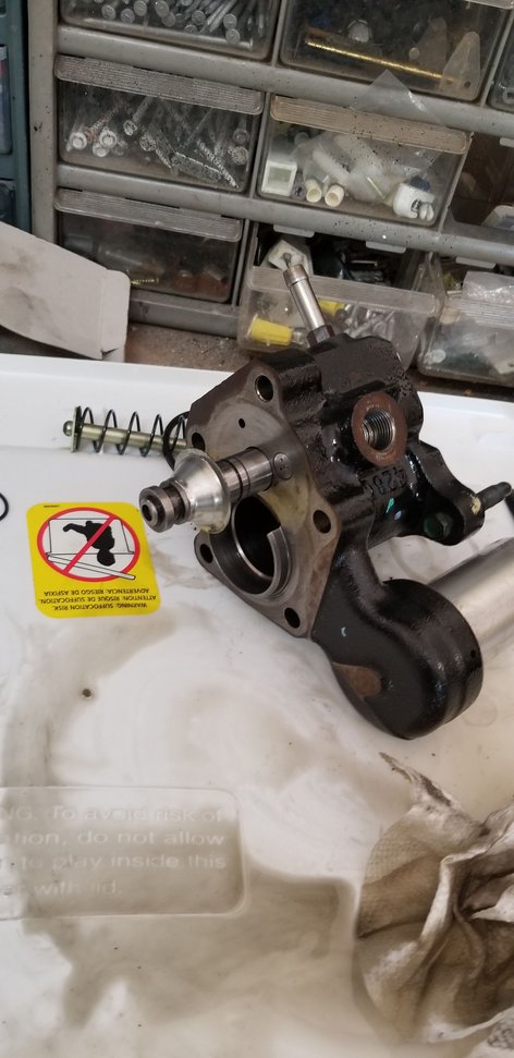

I've been fighting the dreaded steering issues in my H2. I was convinced that the play in the wheel was from a bad steering box. Well 3 boxes later I still had the same problem. So, I decided I would replace everything connected to the steering. Low and behold it turned out to be a completely worn out center link. I had replaced tie rods once before but looking back I never had the truck lifted off the ground to test the sloppiness. My wheel literally had 3/4" play in either direction making for some fun driving on FL roads.

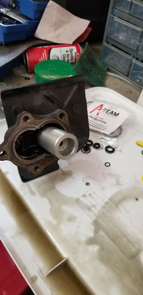

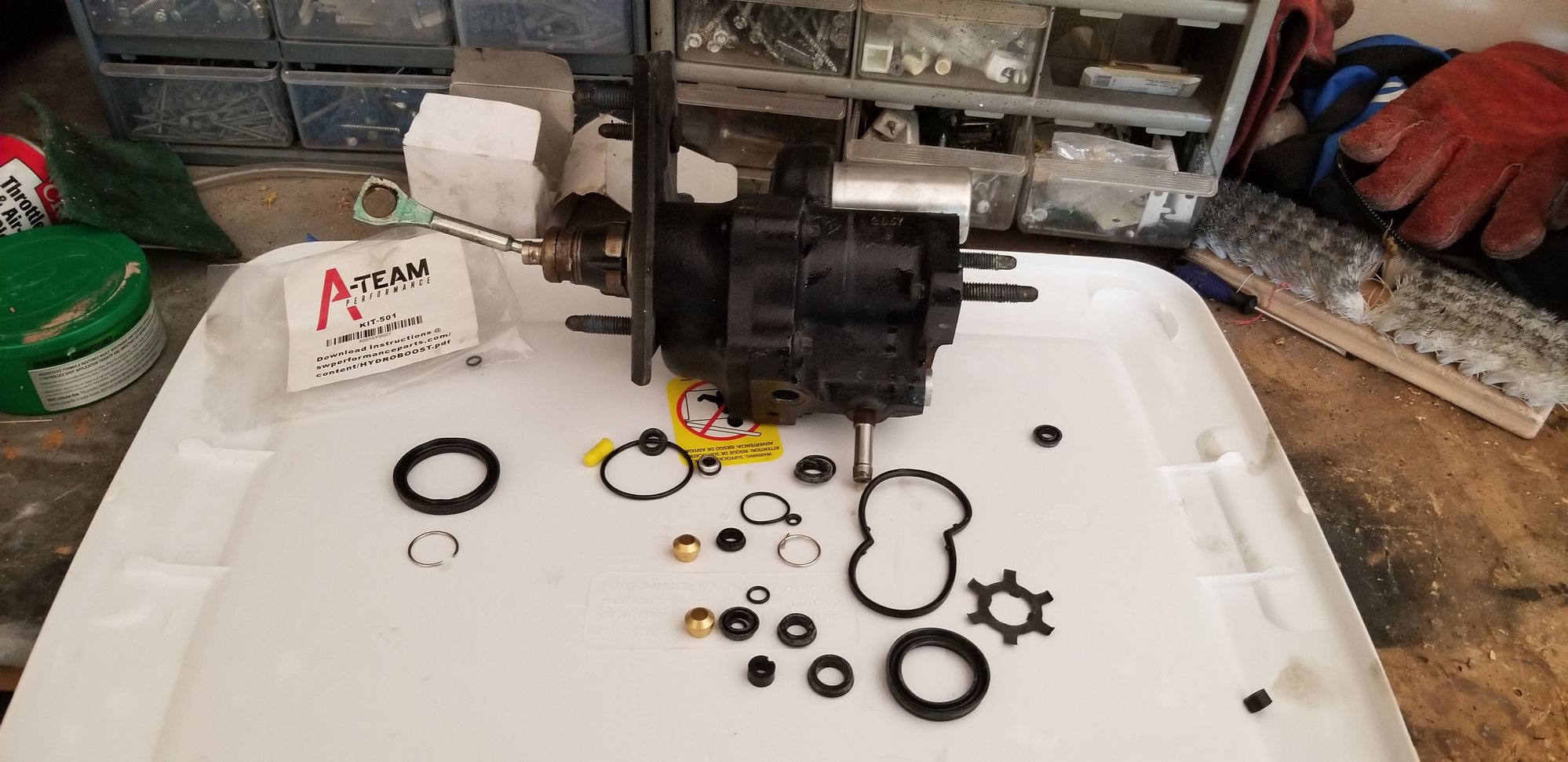

I also replaced my power steering pump, it had a slight wine that bothered me. Once that was replaced the hydro-boost promptly started leaking from the increase in pressure. So that was pulled for a rebuild instead of replacement. I ordered a kit for $49.99 that had every part conceivable versus buying a new unit for $500.00.
Its all back together now and driving like a new truck. I'm going to do a torsion bar lift on the front, send it for new tires and another alignment and life should be good again.
