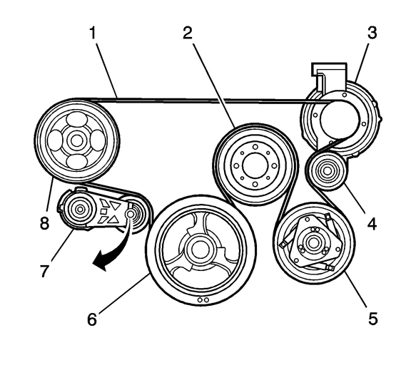

This noise is coming from the engine compartment?
Can you duplicate the noise at a stop? In park or neutral? Or in drive, apply the e-brake and hold the manual brake, while increasing the rpm's.
If you can duplicate the noise at a stop, pull the drive belt and recheck (keep an eye on the temp gauge when running without belt so it doesn't overheat)
