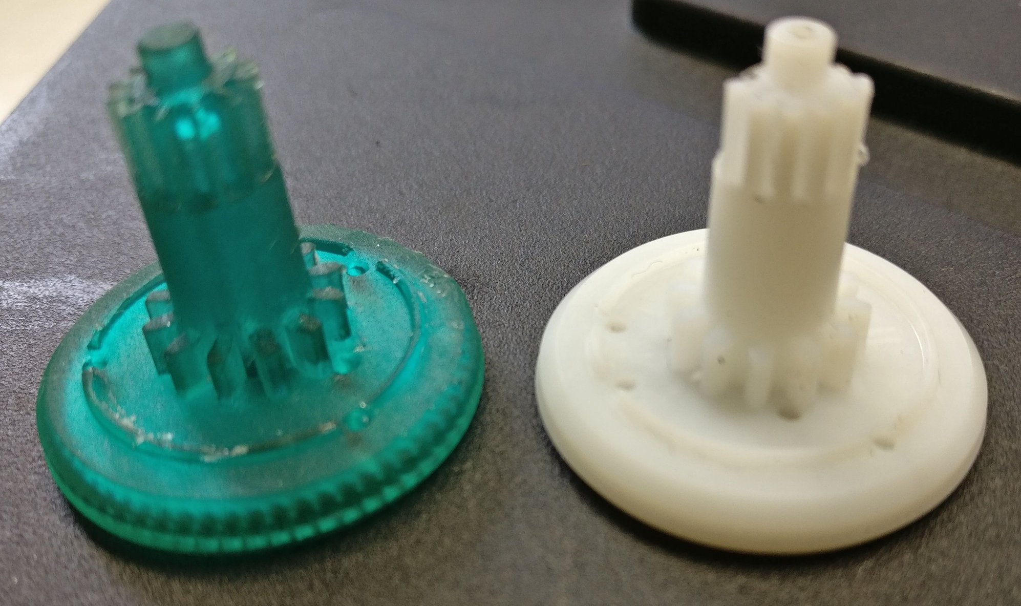

I implanted the vital parts from a Silverado mechanism and refurbished my H2 mirrors, Sadly the Silverado was different, GM replaced the individual motor wires with a single connector, but the plastic gears, pivot-arm and cradle-cup were the same and its these that usually break.
The important thing is there is a repair path available despite the differences.
I actually managed to 3D-Print some gears which actually worked, but the level of intracacy is too high to be viable, plus the material's durability is questionable.
The attached JPGs are for those interested.
