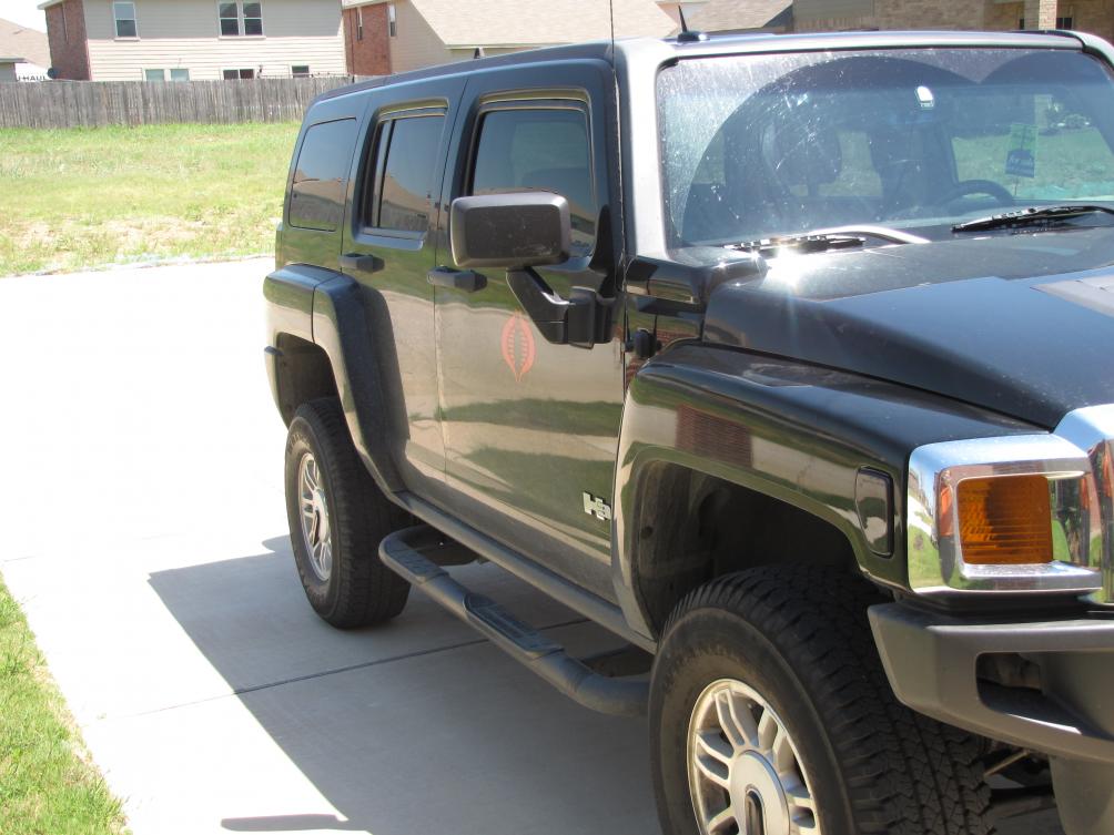

Sorry guys, took a week for me to actually get started, but i just finished. only took about 45 - 60 minutes. i went under the fender-well route. the pins were not too difficult to take out, it's that fender well that sucks to try to move out of the way. it actually looks pretty awesome. still working on blacking everything out. I was only able to upload 1 picture (with a file size small enough to attach). lemme know what you think.
Looks good! Are you changing the front yellow's out too?
