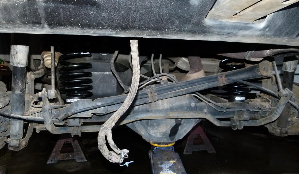

My bags were losing air when I bought my H2. I'm not sure how much the compressor had been run with the previous owner, so I decided to swap in coils (Arnott) and ditch the air set-up before something else went out. I pulled the compressor out and only had the "service air suspension" message come on after the first start-up. Nothing since then.
I put a 1.5" spacer in the rear (Energy Suspension) and tightened up my front torsion keys. The springs were a little stiff the first 50 miles, but feel great now. I can't tell a difference.
