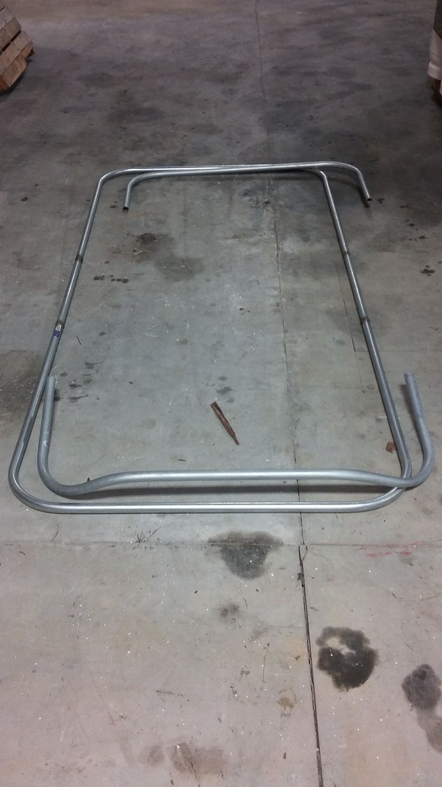

just finalized measurements, just started getting the base together. welded this up last weekend and started on the top bar offset where the lights go. more pics to come

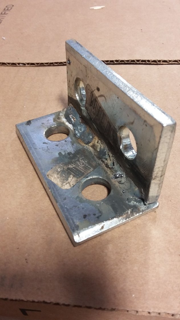

Default IQ Marketing Roof Rack
Here are my mounting brackets they are simple u-strut brackets just welded these up to make a L brackets with a -10% rake to lean towards the base of rack

Welded Mount to H3 u-strut on roof, need to grind out nice and smooth
This is a 4' x 8' sheet of expanded steel 9 gauge, this will nee to be cut to size for the floor
Base is welded to the proper length, need to clean up welds
This is my offset for the top rail where the lights will sit
Got the back of the top rail bent up need to weld it up to the correct length, its getting there.
