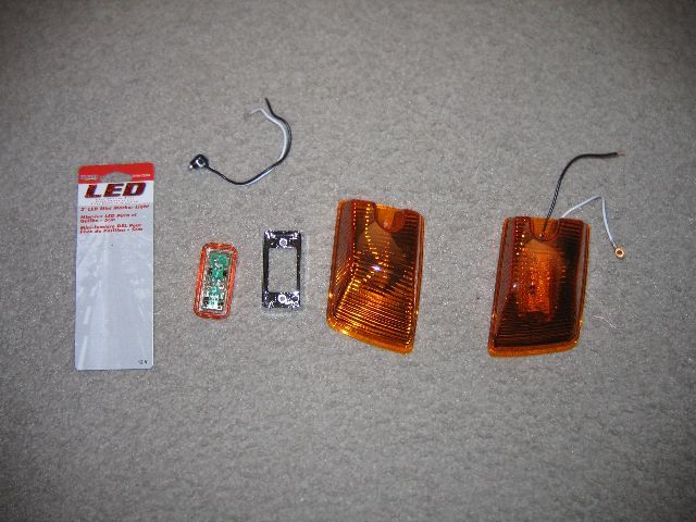

For the front lights, rather than buying the entire marker light set, I thought to save $ by just buying the components... I bought the left and right light pieces from here:
http://hummer.autowebaccessories.com...1309_13004.php
The only problem with the light pieces was I had thought they came with bulbs/wiring, but they just came with the plastic piece! And it was supposed to require some bulb assembly (which I assume would come with the marker light set, which I didn't order)... But that was an overall blessing in disguise for me I guess because I had really wanted to use LEDs instead of bulbs (don't have to change dead bulbs every now and then too)..
So what I had done was to buy LED lights from my local pepboys, drill out the back of the marker piece, put the LED light in and silicone like crazy to seal the gaps.
