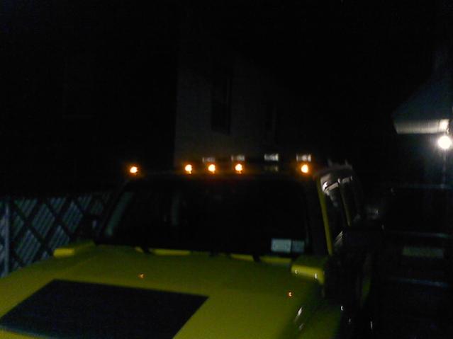

I just did the fronts and rears of mine, here a pic, better ones are on their way. I used the exact same light, what are you planning on using to hook the wiring up?

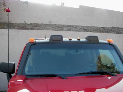

Here are a couple of pics of the front and rear i Installed, and yes there were a LOT of holes I had to drill!

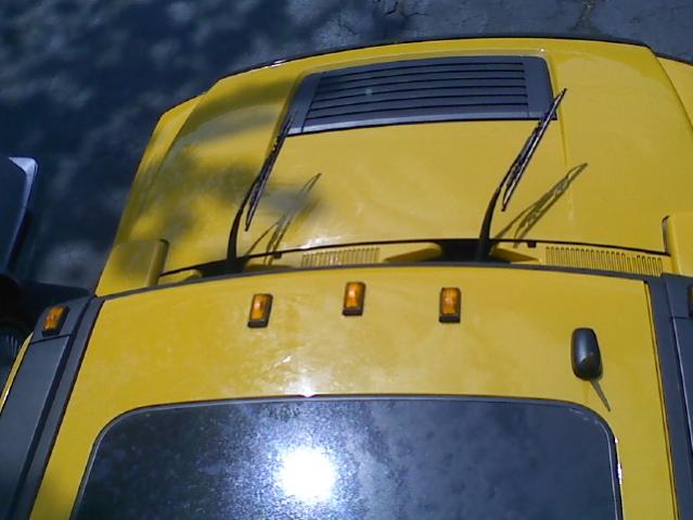

Not sure exactly what you mean. If you asking WHERE my connections will go, I'm thinking of running the two outboard light wires down the 'A' pillar exterior moldings, into the engine compartment, and hooking to the parking light harness. The three roof mount, will go under the headliner, down the interior 'A' pillar molding. I will then ground under the i.p., and run the hot wire to the gray wire coming from the headlight switch. I'd sure like to see a pic of your lights in the daytime, maybe an 'overhead' shot that would show location and spacing?

I mean the part that actually hooks into the light, just wandering if you had a picture of what you used to light them up.
