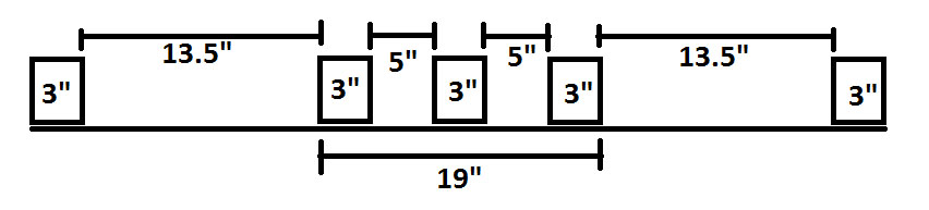

Guys...need some help from someone that has the OEM Roof Marker Lights. I plan on installing my own, individual roof marker lights, but, I want to space them the same as the factory lights. Obviously one is dead center, and one on each side roof rail, but I need a measurement from the centerline of the center light, to the centerline of one on either side of it. Thanks for the info, and I promise to post pics when complete.

Yep. This is measured at the base with a normal tape measure. The OEM lights are all the same size. You may want to adjust if yours are not 3" wide at the base. The leading edge of the lights on the outer pair are 1" from the windshield and 1.5" for the three in the center. Hope this helps.
Here is what I threw together in MSPaint...
Exactly what I needed!! Thanks!!
