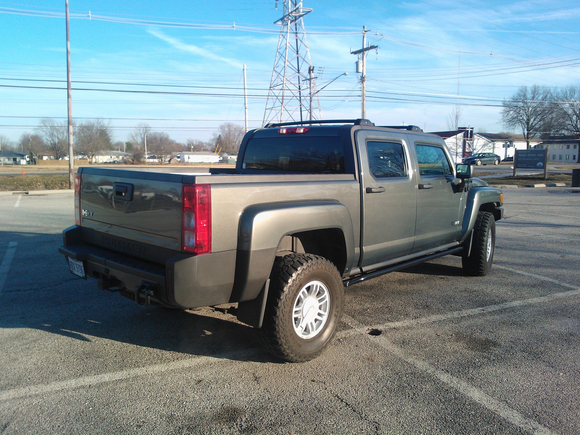

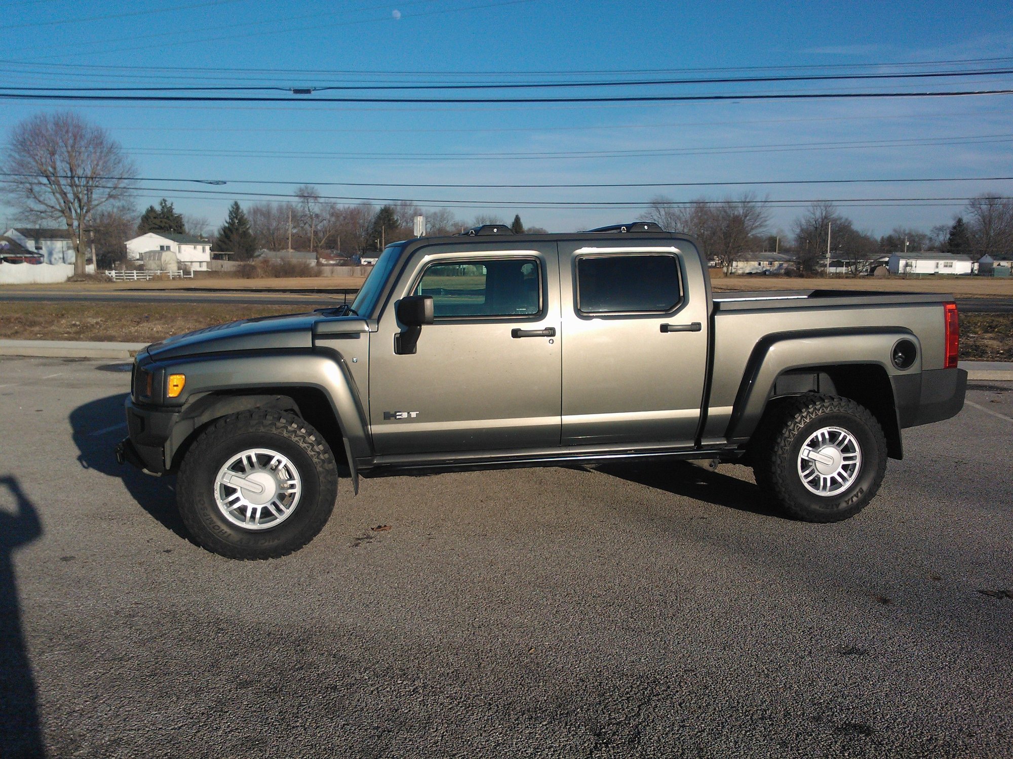

settled, lol. more like beat into submission. its alright i got em on there now. im just glad rocky road still offers things like this for the h3t. took a few pics today after a bath. shes a beaut:

Looks good

oh good. its why i posted it. even after all my nitpicking i want them to make sales.

Nice to see people still appreciate the “T” s still out on the road. Looks good.
