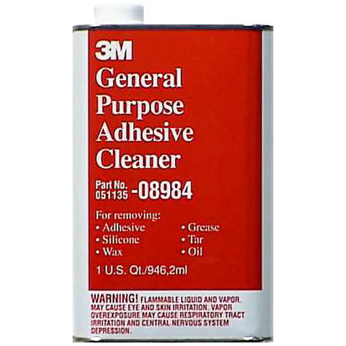

Heat gun is a little hot for my liking, hair blow dryer is better. What could be better to remove the remaining residue/adhesive than......Name:  12174h.jpg

With the WD40 or adhesive remover; do you peel it off first and then use the liquid to get the remaining residue off, or do you douse the area with it and let it seap on and underneath the adhesive before you try to peel it off?
Also, can you buy that adhesive remover at any Home Depot/Menards? (I know I have asked this before, but don't remember).
I forgot about this stuff until you posted it Doc.

The 3M adhesive remover come with a pointy squirt nozzel, you can attach that to pre soak the glue tape if you like. You can buy it at most auto parts and hardware stores. It is pricey, like $13.00......liquid gold. A little goes a long way and will not mess up automotive finishes. I typically use it to wipe off after removal of the emblem/tape etc. with a soft cloth. Great for decal removal, just put some on the cloth and hold it againstany stubborndecal letting it work in, and then if needed, with a little heat, should peel off.Wipe the residue clean.

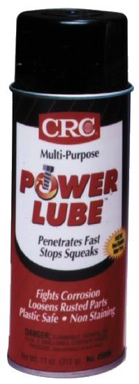

I haven't used that stinky old WD40 in 10+ years. I found that CRC Power Lube is much better, does more and better.
"The next generation of multi-purpose lubricants. This all in one product quickly penetrates, lubricates, stops squeals, fights corrosion & loosens rusted parts. New & Improved formula is odor free." doesn't stain and improves electrical connections! I use it all over the boat. Salt water boating turned me on to this stuff.
Size:  17.8 KB Why don't I have stock in this stuff? Gotta call my broker.
