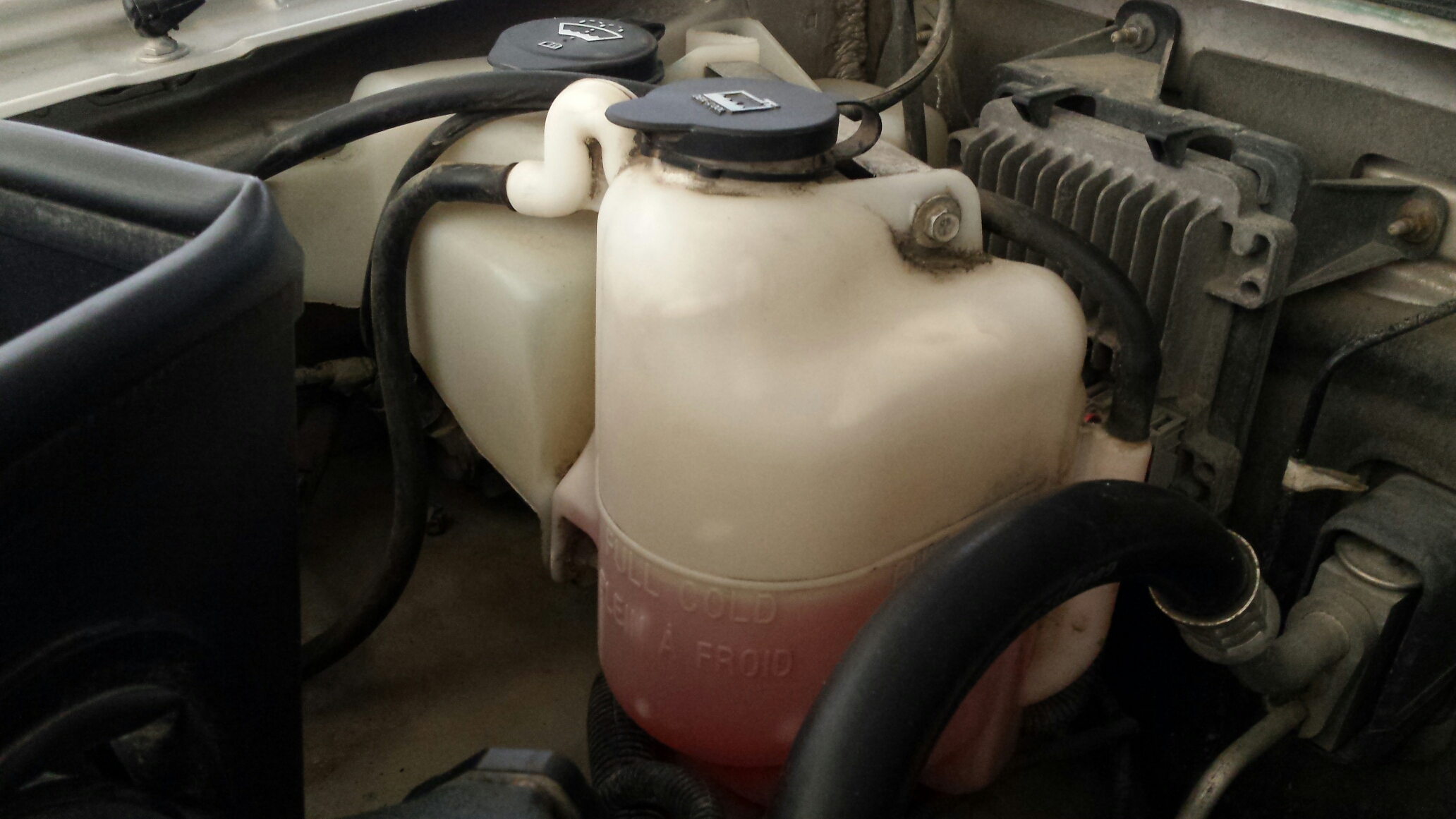

Hey guys,
I have a universal pump from ac delco and attempted to fix the rear wiper pump yesterday. Symptom: not spraying.
I couldn't find the location of the pump. There is one on the bottom of the reservoir, but it's not the same part. Removed two bolts for the wiper fluid/coolant reservoir and something is still holding it in place. Tracing the lines, I can clearly see one that leads under the reservoir, and one that leads to the pump underneath.
Can someone share pics or a diagram for this installation? Just need something to reference.
Josh

There are 2 pumps on your reservoir if you have an H3. One for the front the other for the rear. The forward pump is for the rear.

Thank you, but problem I cannot seem to access the rear pump. Besides the two bolts on top, what needs to be removed? Here's what I'm looking at.

any suggestions on how to access and remove the rear pump?

anyone? Diagram, advice, something?

refer to service manual that has intense detail.buy, download free, steal, beg!! its all in the book.

Attached is the service manual for the wiper washer, hope that helps.

Thanks Khaled, that is all I needed.
