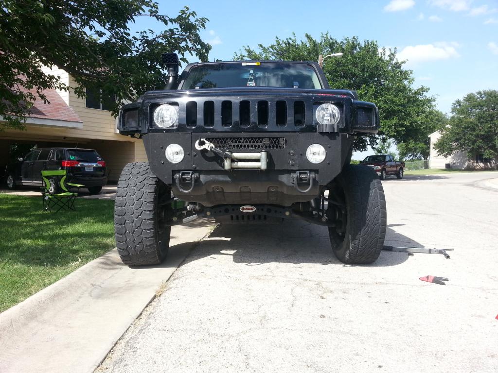

Old Jul 8, 2014 | 08:39 PM
skeeter's Avatar
Joined: Mar 2010
Posts: 645
From: Oklahoma
what tires are those, and how do they perform??
Old Jul 8, 2014 | 08:52 PM
SolidJJ's Avatar
Joined: Jan 2010
Posts: 363
From: FT HOOD, TX
Pro comp xtreme AT's. When I got them they were pretty choppy but they have even out and seem to get the job done. Going to take them out in the trails soon and see what 35's can do.
