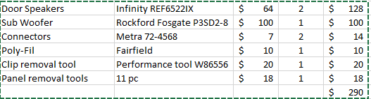

Replace your subwoofer while you are at it. Here is what you need:
Most of the stuff is available from Amazon.
