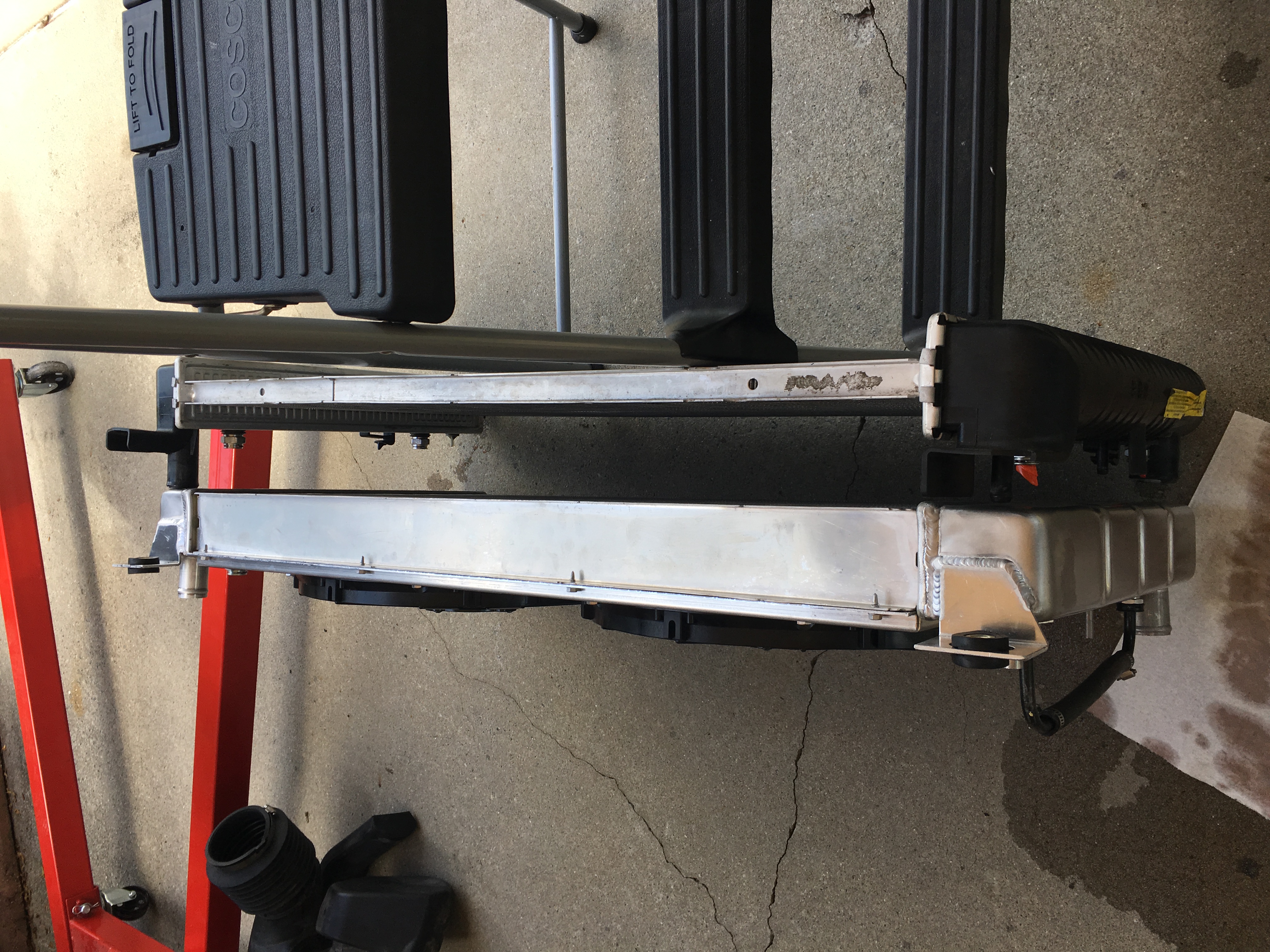

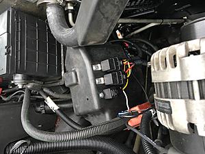

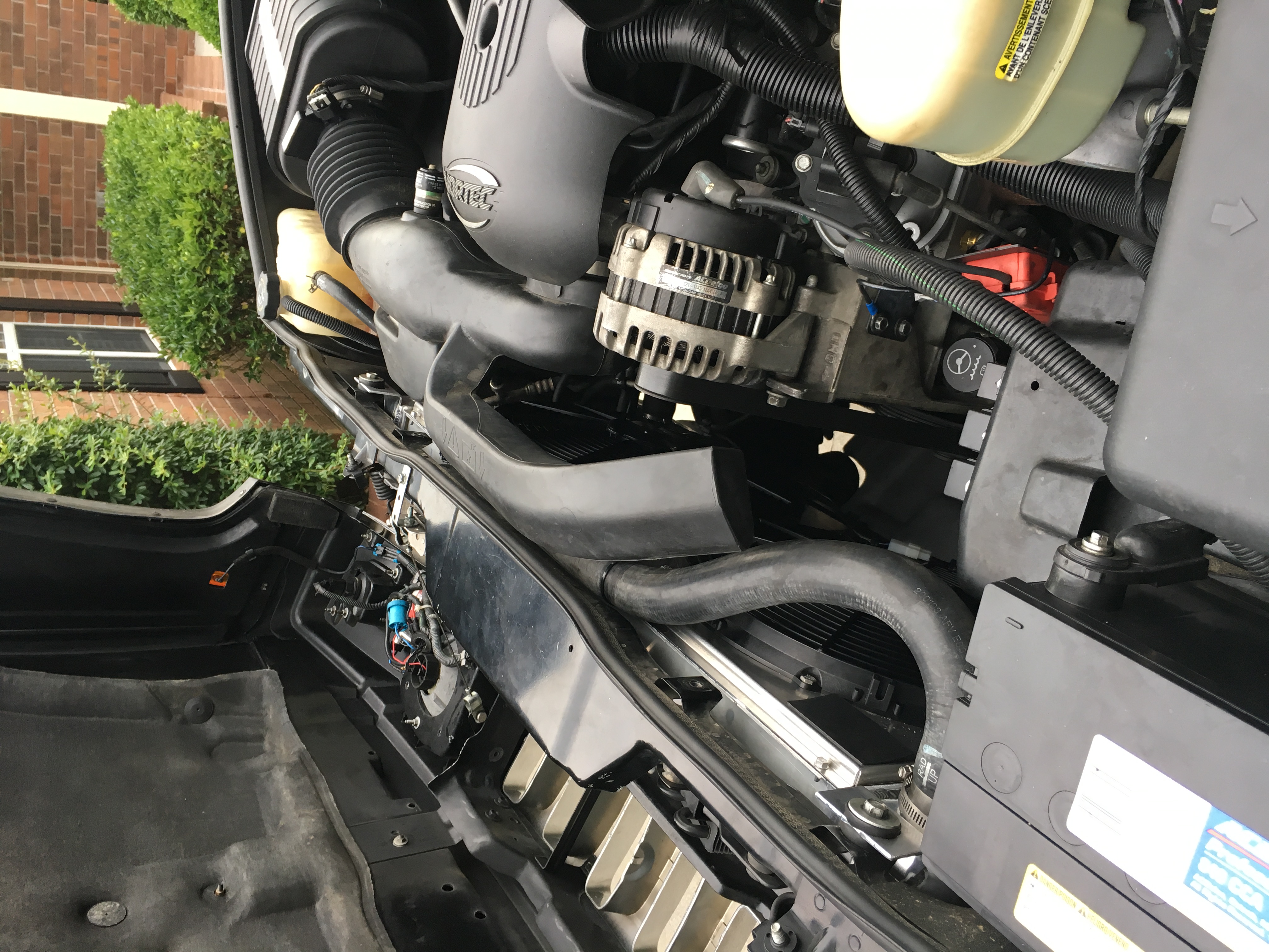

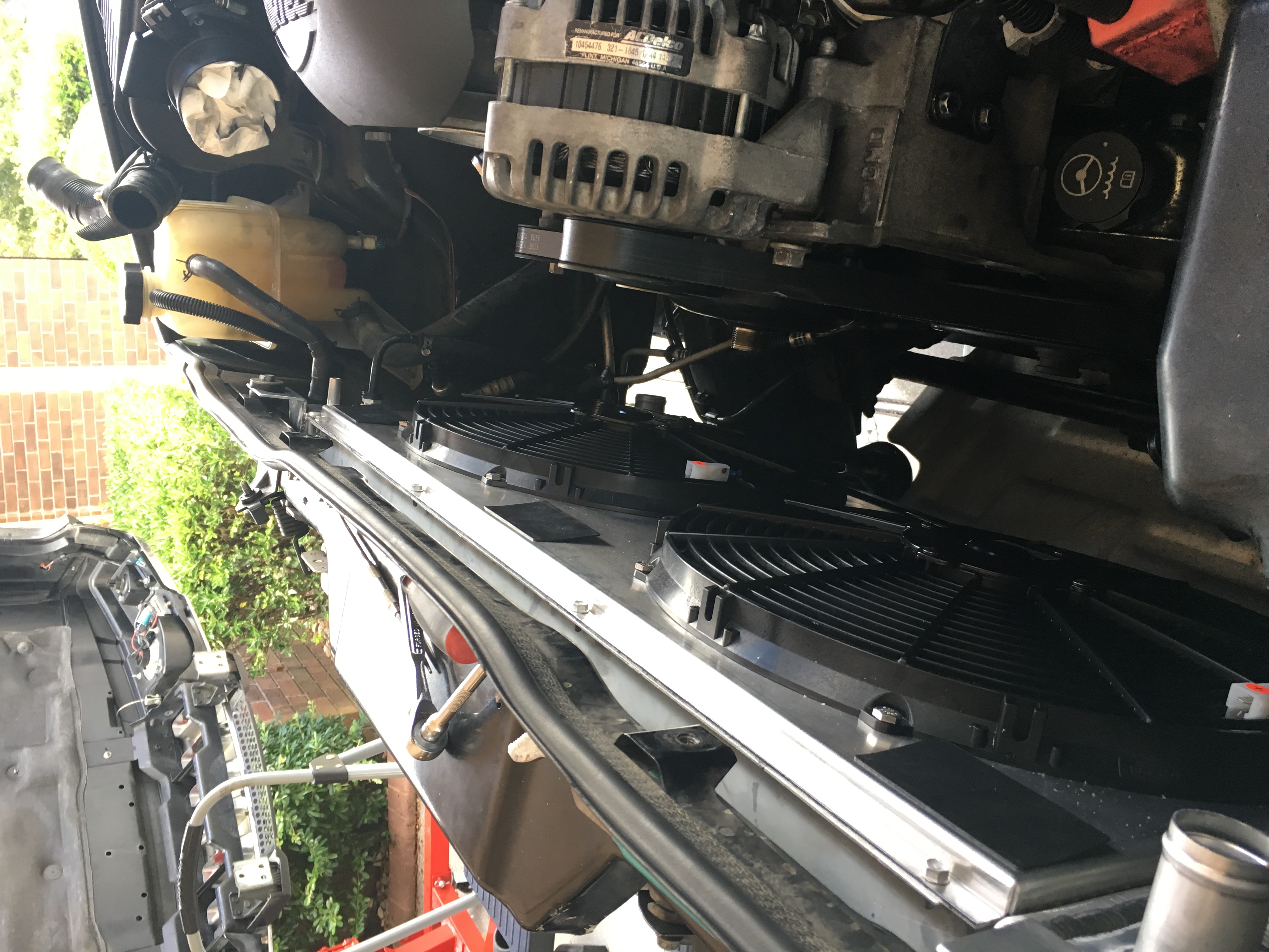

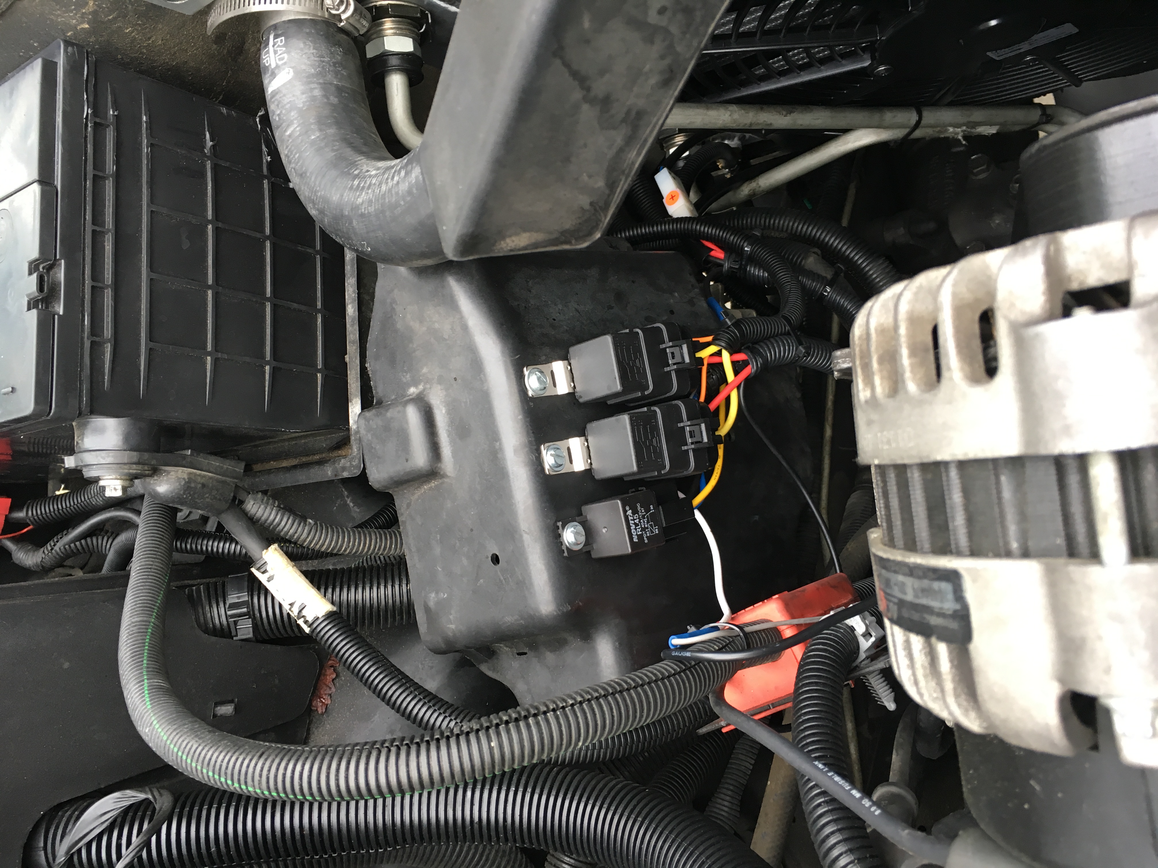

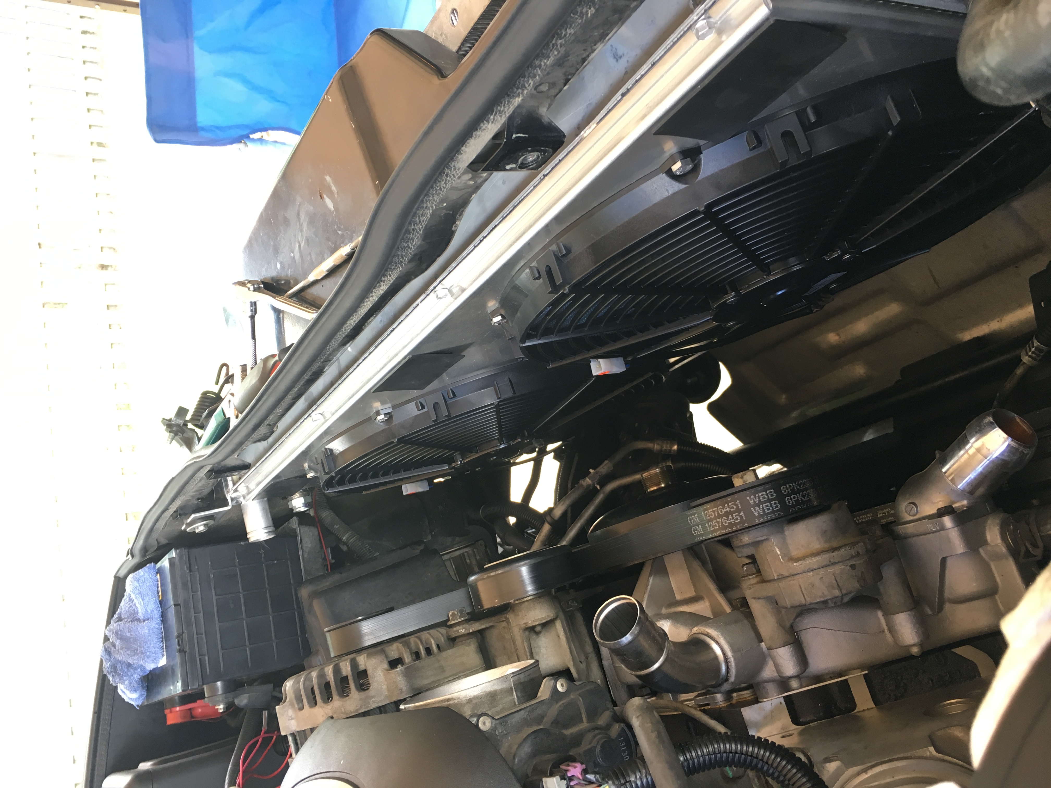

Here are a few pics of my 2003 h2 with Griffen radiator install

I am curious on those electric fans.......

Best upgrade I have done. Easy to do
