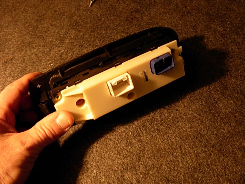

Did you pull the whole assemble out or does just the switch pop out. I think you have to lift the whole panel out of the door.

Sorry Doc but no luck on this. Pulled 77 but no luck there. Pulled the switch assemble out with no problem and unplugged the blue and white connectors and I will let it sit overnight inside and plug it back in tomorrow morning like another forum said. If this doesn't work then I guess I will be making the one way hundred mile trip to get to a hummer dealer who knows what they are doing. Thanks again for the feedback on this problem again.

Yes, I agree this is a hit and miss thing. Still it is a little better than my C5 corvette which was turning into a nightmare. You were lucky that everything still worked. I went in to start it up and my key would not come out either till I charged the battery and started the H3. I should be thankful that the key came out. I have now taken the whole switch panel out and we will see what happens when I put it back. A new one is over 200.00!!! I really did not expect anything less being a past Vet owner.
