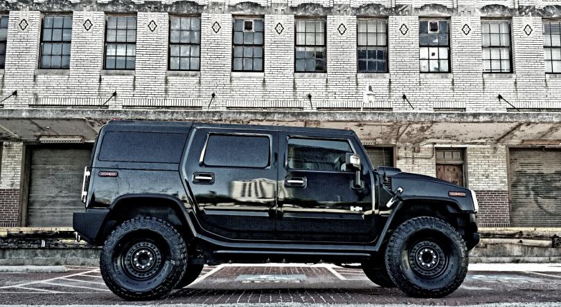

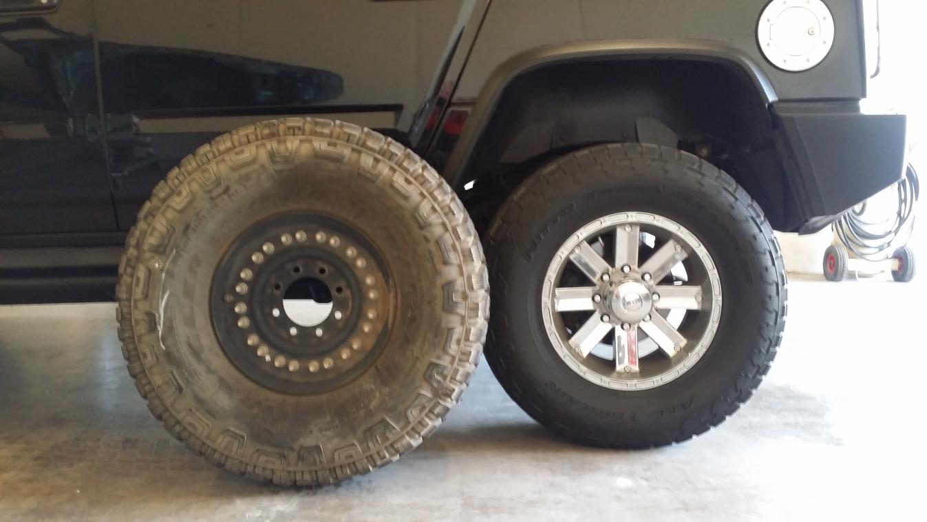

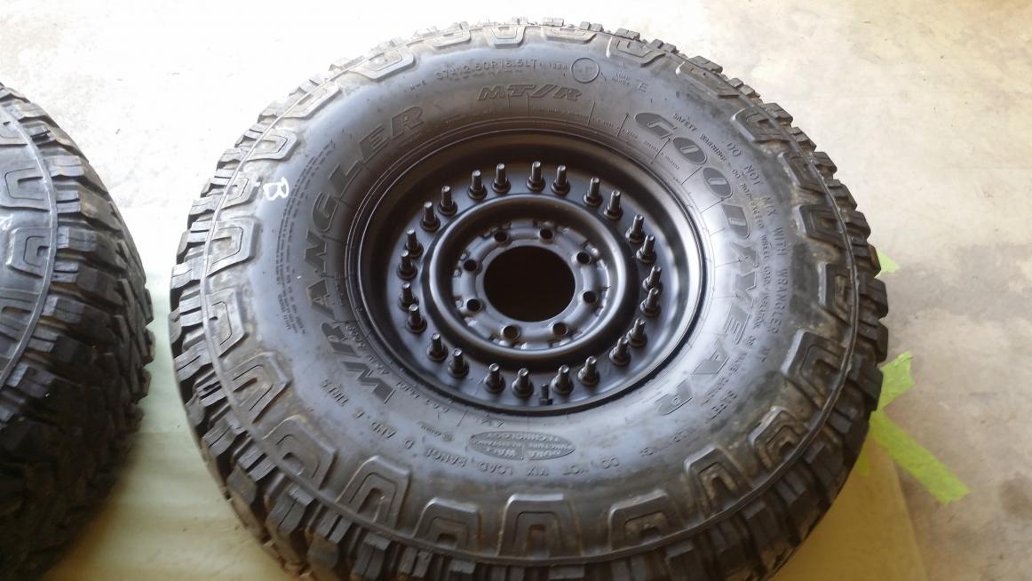

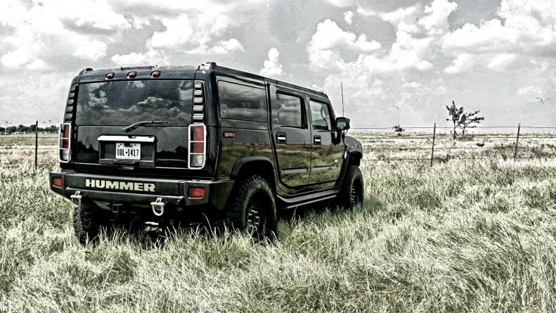

I got mine from www.rallequip.com great business to deal with. Be prepared when you get them to clean them up, have a local semi shop dismount them, inspect and reassemble with fresh rim half seals and balance them correctly for highway use. Here's one example of their packages, when I got mine I was able to get 95% tread and when they arrived they were new and probably just had a hummer rolling around on them before going to surplus (http://www.rallequip.com/Goodyear-MT...095WHEEL-4.htm).
The tires with runflats installed are HEAVY so be prepared to have to do hub work sooner rather than later as it takes a toll on the control arms/hubs/etc.
From my research you don't want the 8 or 12 bolt wheels - they aren't as strong as the 24 bolt wheels and are older in design. The 24 bolt wheels are safer to run on and off road and less prone to leaking air.
Lastly, you will need 2 or 2.5" spacers as the Humvee wheels do not have any backspacing and the H2's require it to clear the brakes etc. Don't go cheap on these (spacers that bolt to the hub which have lugs pressed into them to bolt the wheel onto) as they are critical in keeping everything together. Use locktite!
The tires are a bit of a handful on the highway and not as grippy as my Terra Grapplers were but I'm okay with that and drive accordingly. The tire compound is much harder on the MTs and you will get small vibrations periodically as there is only so much they can balance them, but again its not really noticeable and I keep it under 85 at all times.
The wheel setup looks great - just be prepared to trouble shoot any issues and take your time during the install of the spacers. Feel free to PM or post up with any additional questions if you're thinking about going this route - I'll pass on and collect the other threads where I gleaned knowledge before I committed.
