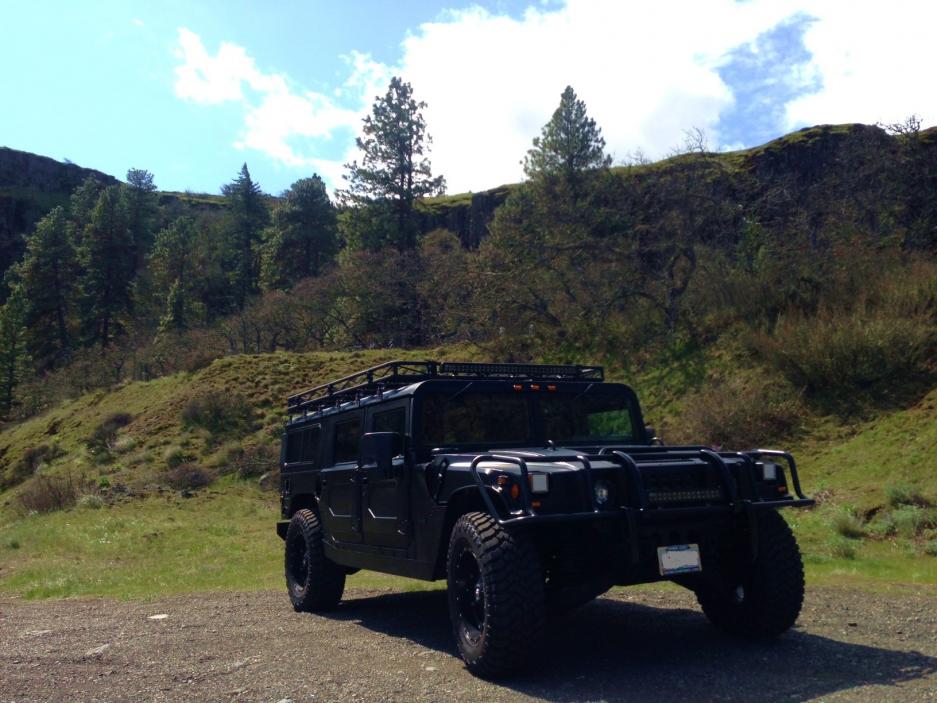

Hey all, new to the H1 scene and so far a bit discouraged with my purchase. Bought a 2001 wagon with just over 18,000 miles on it, and already sunk another $4000 into it for minor things(nothing in the engine bay). Well, that may have to change quickly as it died on me twice today. Needless to say, I'm bummed. I've read about the PMD issue, and noticed it has an aftermarket PMD/relocation kit, but it's the set up where it's bolted to the top of the intake. It wasn't running super hot the last time it died, but I was in downtown Portland OR traffic, and it scared the crap out of me as there was no shoulder. Anyway, was wondering if anyone has had success with Predator products. Was considering a stage 3 kit as they claim it's about an additional 155 HP gain, with mildly increased cooling...anyone ever done a stage kit or had luck with Predator stuff OTHER than a Duramax upgrade?? Thanks!
