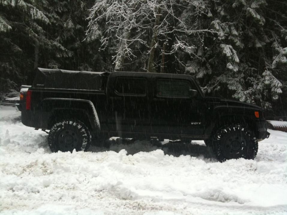

I'm talking to a local shop about making some mods to my truck. They're suggesting 2-inch torsion keys for the front end, but I want to get a good idea of what this is going to look like before I pull the trigger. Any leveled H3T's out there with good profile shots to share? My thanks in advance.

I suggest you save your money on the torsion re-indexing keys. You DO NOT need them to level your truck. There is a **** tonne of room to adjust the stock keys to get the truck level. Level it and spend your money here http://www.trailduty.com/product_inf...roducts_id=765
There are a billion threads about this all over this and every HUMMER forum and I have posted some helpful links in other threads about this topic. Search man...

Dude, I did search. That's why I didn't ask for opinions on how to achieve the level, because there is a ton of info available on the subject. I only asked for profile (side) pics of leveled H3T's. And I appreciate the pic you did post.
