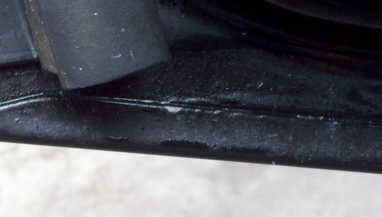

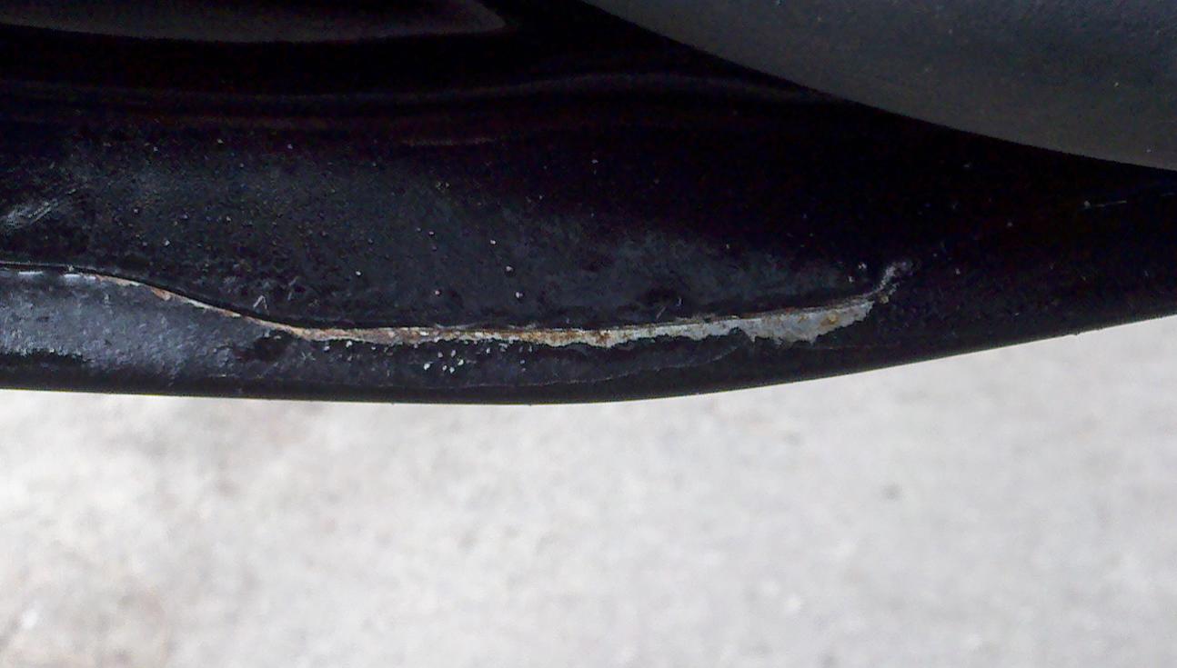

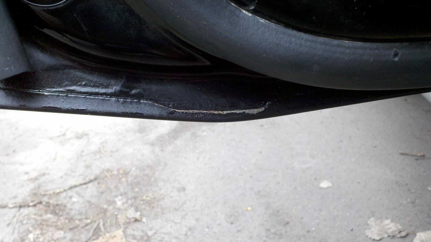

It not from the water inside the door, it's seems to be from paint flaking off. The rear door of my 2010 H3 has paint flaking off in that exact area and it's starting to rust. There is a design/manufacturing issue of some sort. The paint just doesn't stick to the metal in that area very well for some reason.
I attached 3 pictures of my issue.
To give some background I have a 2010 H3. I'm from Minneapolis, MN so we do have salt on the road in the winters and such. All the pics are of the same door which is the rear drivers side door. The first 2 pictures is of the same rust spot. The pic H3_Rear_Rust_1 is a wider view and H3_Rear_Rust_2 is a close up. H3_Rear_Rust_3 is a new spot in the last weeks or so that the paint just pealed off and the metal is exposed.

Well the paint is bubbling because moisture is behind it.
jvorpahl - Does the bottom of your door have another layer of something on it? In the pics it looks textured like bedliner at the bottom. Aside from the bubbles
