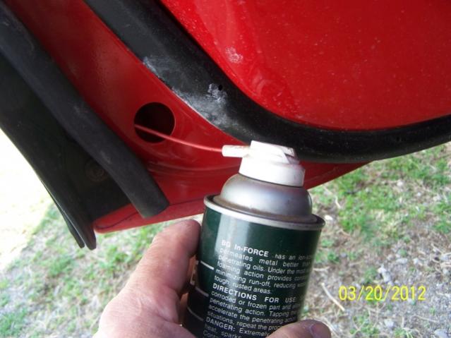

imagine a picture of me spraying some BG products foaming lube in the hole in the back door. visualize it running along the bottom and dripping out at various places. i cant post pix today?? so you just imagine it!! im doing it on all lower sheet metal. the forum is taking forever to post .

some time it works,other times,,,
I was thinking of doing the same thing, only using WD-40, but your BG In-Force looks like a better option. Where do you buy it?.....wait...let me guess....not...Walmart?

"a friend" who got it from "a guy" who i am sure stole it at work years ago!!
i have no idea where to get it but i also have another ? similar product. brain phart,cant remember!.
so just spray a heavy bodied juice that sticks. better than water huh!
