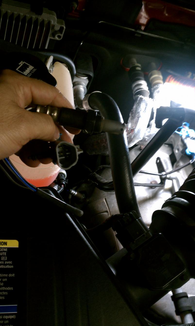

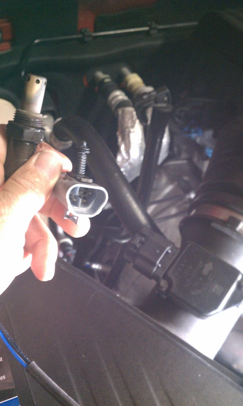

Got my new O2 from Rockauto.com it was a perfect fit and everything is doing fine. Weirdly though seems like she doesn't have as much pick up when first starting the motor
Here are some pics of the the old sensor where you can see the fouling. Shucks didn't take a pic of the new sensor, but it had more holes on the actual sensor than the stock. Hopefully this will keep it from fouling so soon.
