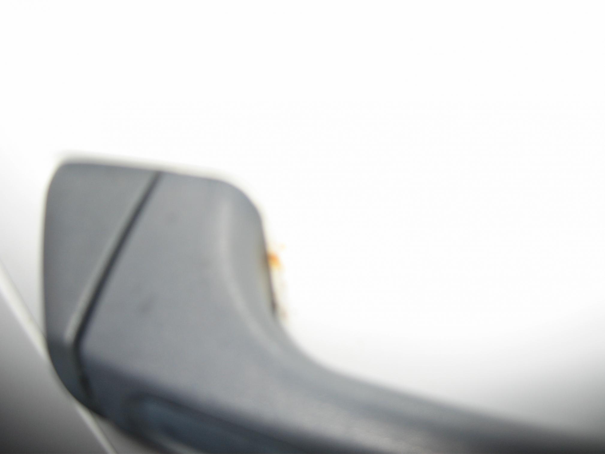

I have a friend who used to be a GM engineer in Detroit. He just took a look at it and said it looked like rusting metal flake in the paint - so - the rail dust sounds like a good explanation.
It wasnt easy geting clear pics of the white H3 (glare), but I took one of a spot in the inside of the door handle.
This Hummer is starting to look like it has chicken pox
Attached Thumbnails Orange / Yellow Spots-spot-2.jpg

I'd never heard of that before.....
Plenty of folks with the complaint, but no explanation or name for it...
Then one day Doc popped up with that or a similar link.
Pretty widespread apparently....Google it and see all the stuff that shows up on the subject.
