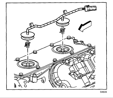

No one has anything??? I drove for 20 minutes yesterday. Truck seemed sluggish but it was windy so I didnt think much about it until the engine light came on. I scanned it and now have
PO 327- knock sensor
PO 332- knock sensor

If DTCs P0327 and P0332 are set at the same time, inspect for poor connections at the knock sensor harness jumper, located at the left rear side of the intake manifold. If the connections are good then check for poor connections at the 2 knock sensors. It's been known to go bad from water and dirt. Goodluck.
