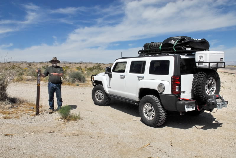

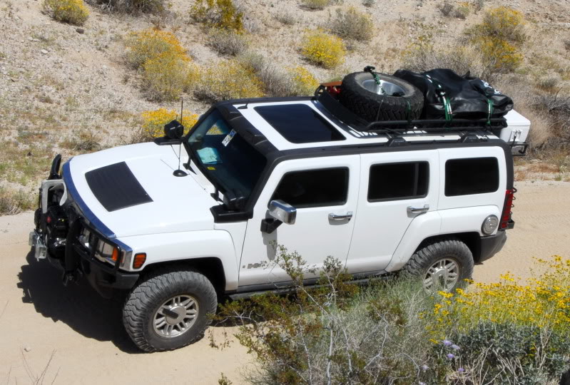

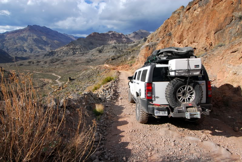

I guess there could be more versions of these but there was a guy on one of the forums that worked where the OEM were made. After a period of time they were allowed to resell to other distributors except for the Hummer trademark, so they did the stick on letter option for those.
I have had a set of the aftermarket that are aluminum just like the OEM and compared both types of ends. They look the same to me but both kinds need a washer under the spring on the slider that goes in the rail to fit tighter and have to be on an area of the track that it is not recessed. I have the same set on my 08 Alpha that I had on my 06 H3.
My aftermarket sourced units seem to be holding up well. I guess because I never overload them and then go offroad.

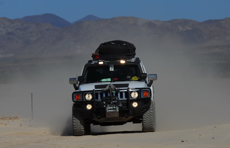

Two Cooper 315's on Hutchinson Beadlocks
