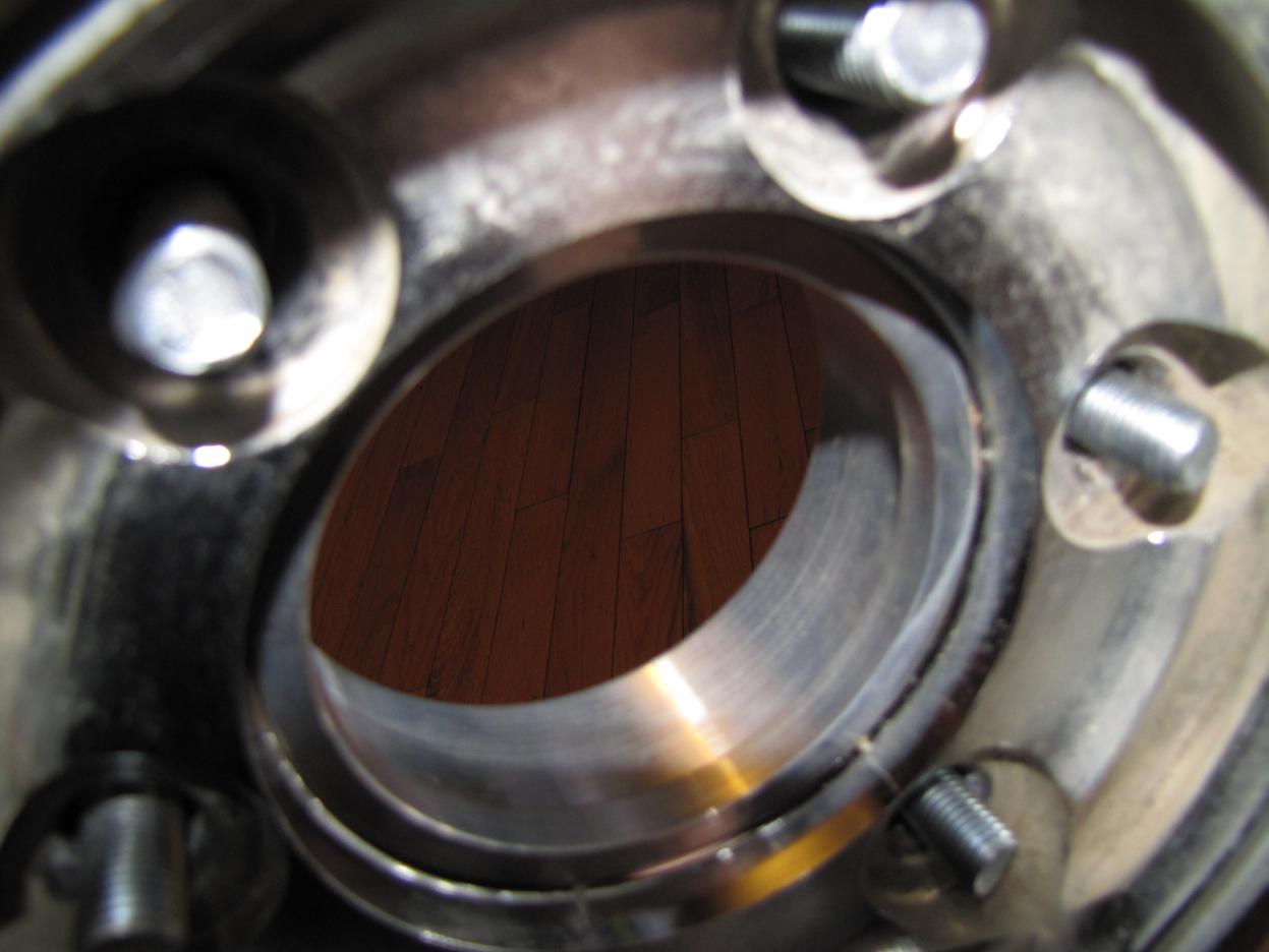

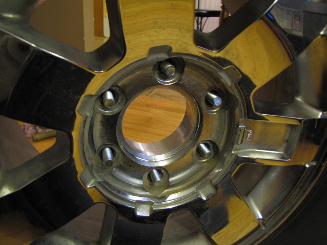

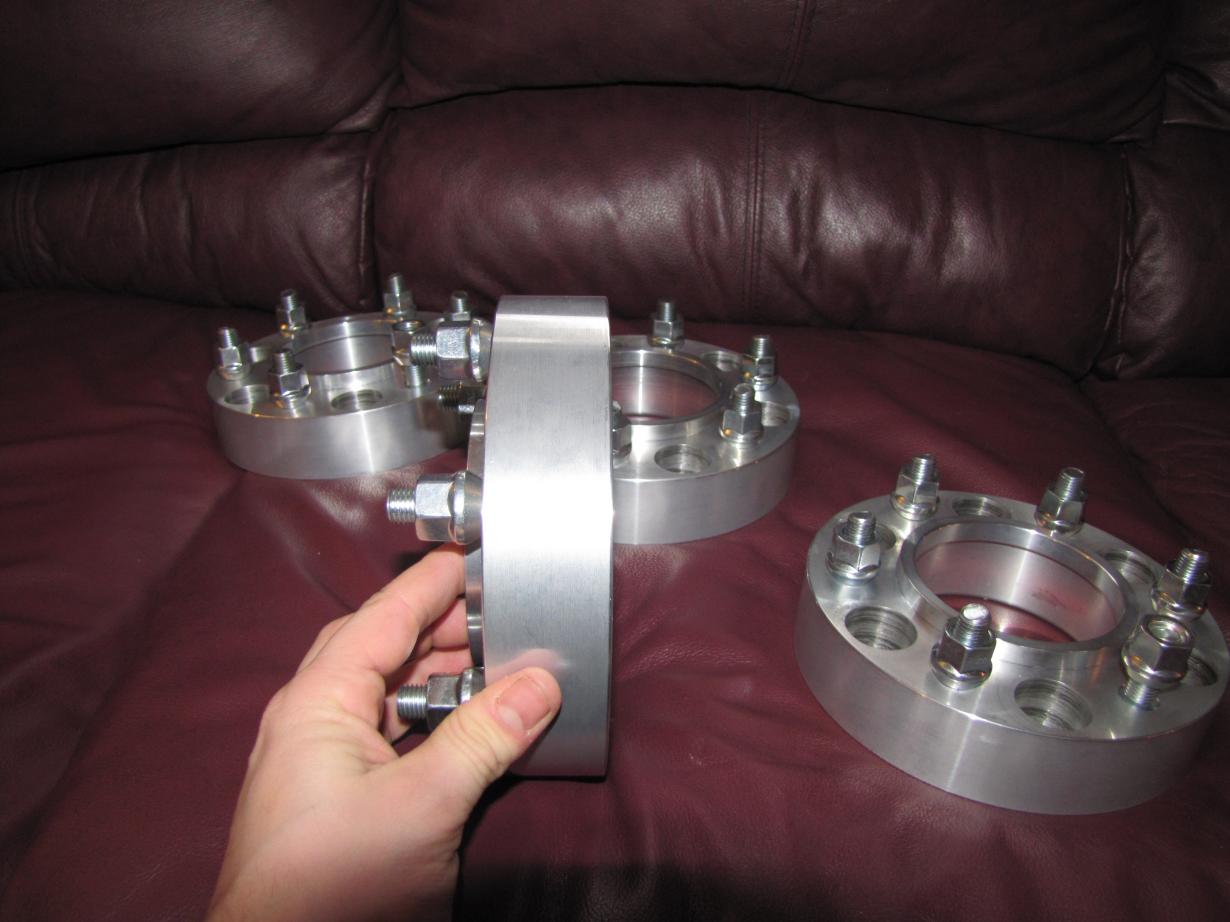

New wheel adpters just got in. Just waiten for the liftThis is so I can install the rancho lift with stock rims.
Wheel Adapter Configuration - Complete!
2010 HUMMER H3T
Your Bolt Pattern: 6x139.7mm
Your Hub Diameter: 100mm
Type: One Piece Adapter
Hub Centric to Car & Wheel Centric to Wheel
Thickness: 40mm
Stud Size: 12x1.5
Center Bore: 100mm
Diameter: 6 by 139.7 (5.5 inches)
Quantity: 4
Attached Thumbnails New wheel adpters just got in-img_0241.jpg   New wheel adpters just got in-img_0242.jpg   New wheel adpters just got in-img_0243.jpg

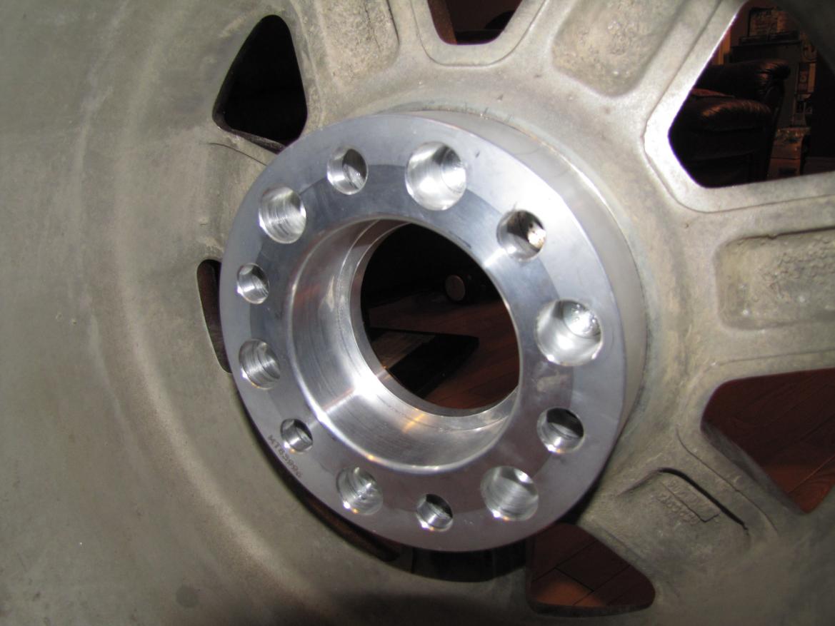

hmmm it better not be lol I'll have to test fit it today..

Tainter just tested them on the stock rims. They went on no problems at all. Thanks for the tip better to test just to make sure lol..
so 2010 h3t alpha must have a 100mm center bore/hub..

Bigunit you maybe right who knows.. but my 100mm adapter fit perfectly on my wheel. I have not tried them on the hub but if they fit on the wheel they should fit on the hub as well. My outer and inter are the same size.
