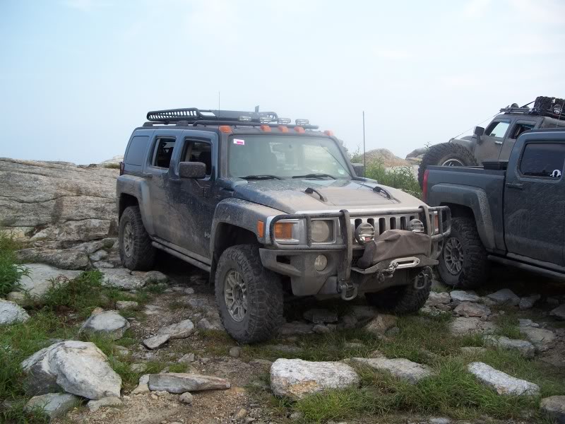

If the marker lights that you want are the OEM ones like mine below, then those marker lights were available only through the dealer parts department. It is going to be extremely difficult to get a set. They are no longer being produced. A few sets may be sitting at a dealer somewhere. It's going to take some digging to find them. Good Luck

Be careful if buying a used or take off marker light kit.
The installation requires you to drill 3 holes in the roof and install some type of threaded rivet which becomes a permanant part of the install.
Those rivets are left behind if you remove the marker lights and unless someone has gone out and found a set of those rivets to include in the sale then you are going to be searching for them yourself. I don't know how readily available they are, so beware.
