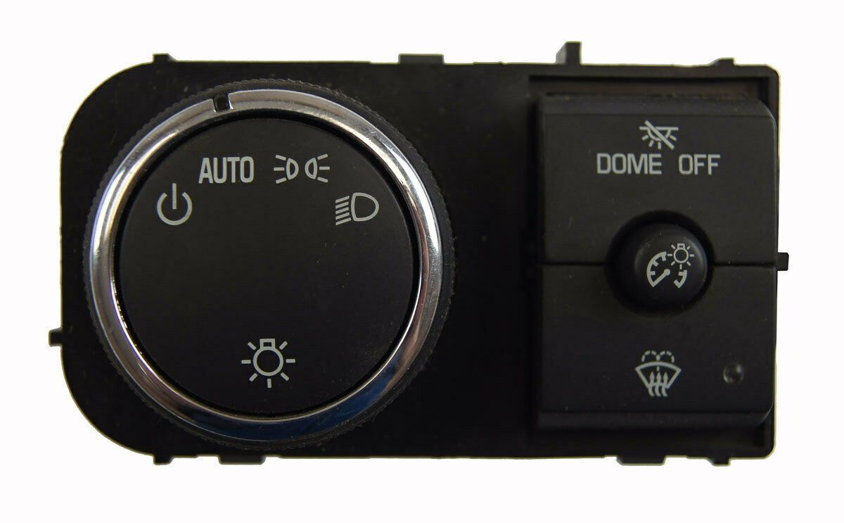

Could that extra button be a water heater? My friends truck has a stock water heater, so I assume there must be a switch somewhere.
Correct! Heated windshield washer 2008-09 was integrated in the hl switch. 25858427

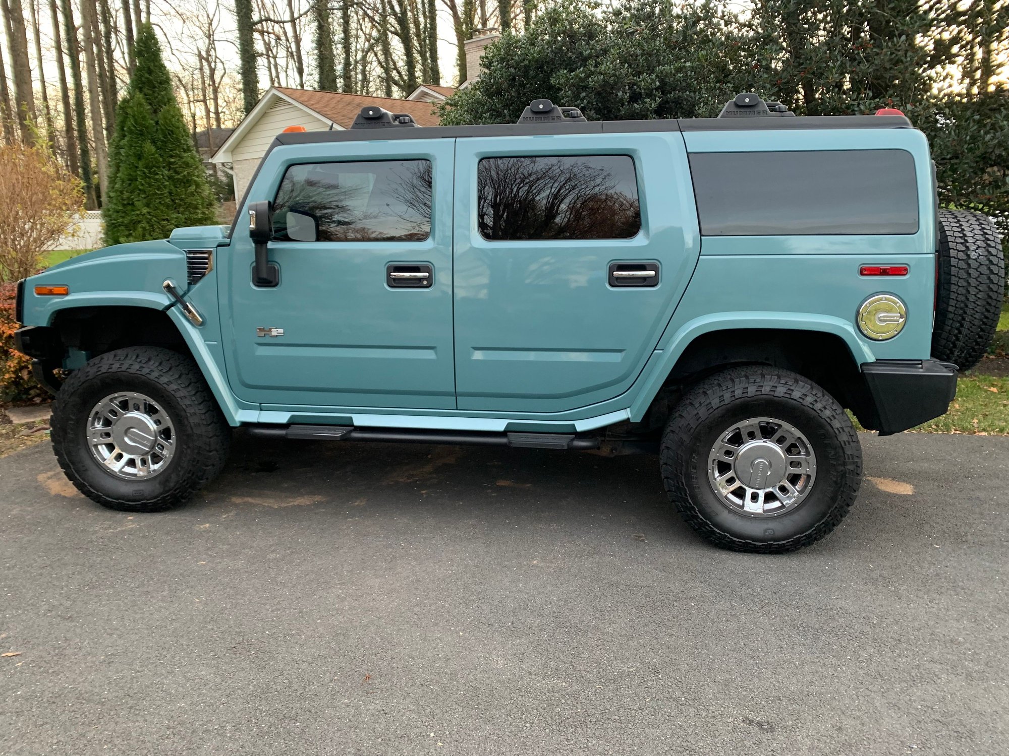

This late 07 glacier blue is a special edition with roof bar lights.
You HAVE TO remove those 4 black plastic covers. Do it now.
Because if you accidentally turn on that overhead switch, those covers will melt and pool on your roof and sunroof.
And buddy, it WILL happen, sooner or later. Mark my words. Dealer did that before we even picked up our Victory Red SE in 2007.
I did put clear headlight wrap on them, when I did the other headlights and driving lights.
Besides, if you need to use them quickly in the rain, you can't with the covers on. Wait.....never mind,
They are useless lights. Completely useless and low powered. Fortunately the manufacturer offers stronger LED replacements for that bar.

There was a recall, and most (except mine and very few others) did not escape that heated WW fluid gizmo to be yanked by GM due to fire hazard.
Likely your switch will not NOTHING. GM instructed techs to literally cut the wiring harness and tape it off. And to remove the WW fluid heater. Guys without an SE do not know about this.
The supplier went under, then got bought out by someone who was supplying these same units, but aftermarket. I got mine a decade ago from them: Alphatherm
There was also more than 1 version of the aftermarket unit form them, and it had to be programmed by the maker to work on the H2.
Maybe they updated that, as mentioned here:
https://www.hummerforums.com/forum/h...-wiring-39021/
I have to tell you that this heated windshield washer fluid feature is Excellent! Really removes the bugs or ice.
Look for it. The heater was located right in front of the WW fluid reservoir, and looks like a black plastic binocular case positioned vertically. Is it there?
It will not be if the recall was done by previous owner(s).

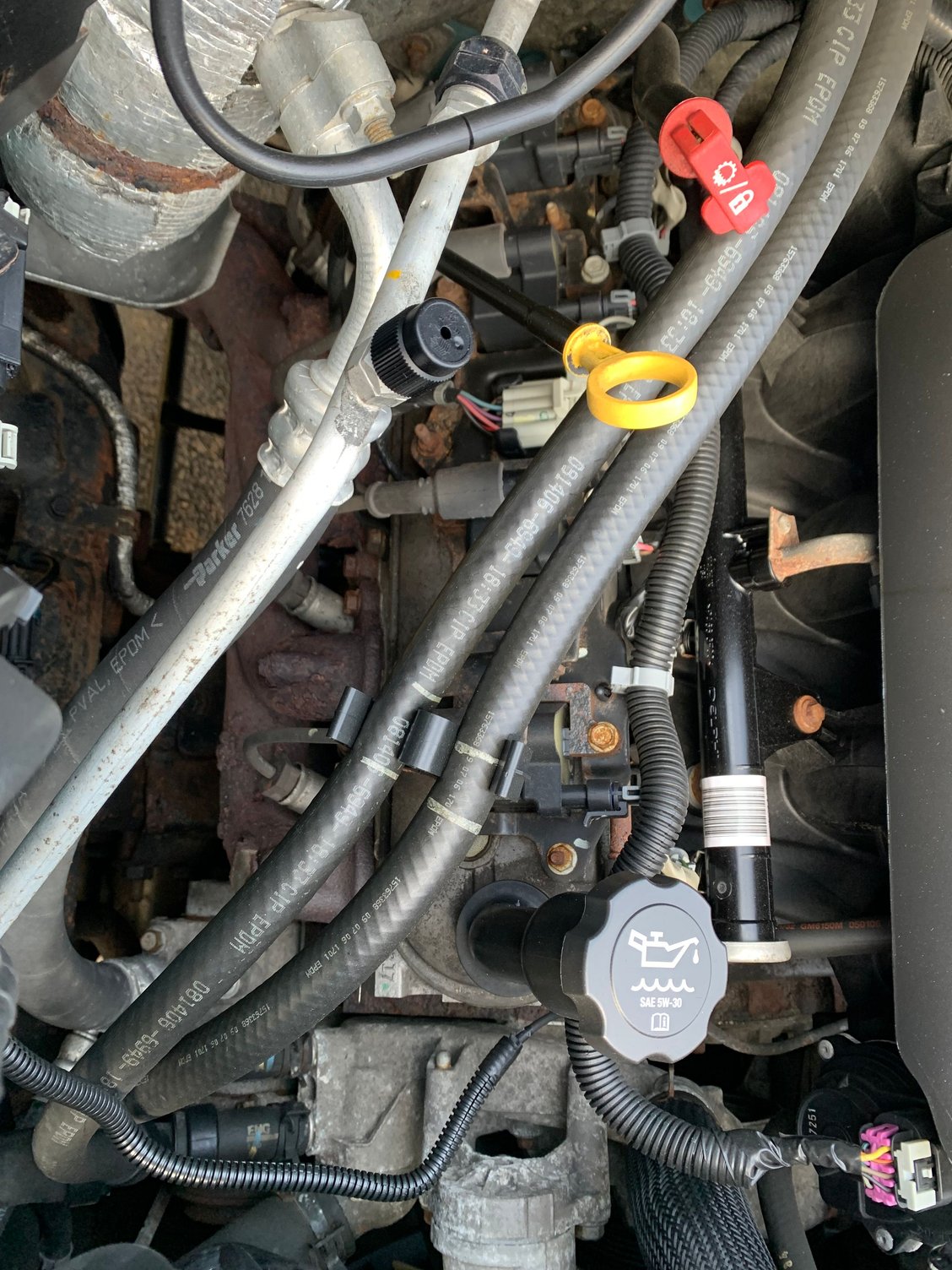

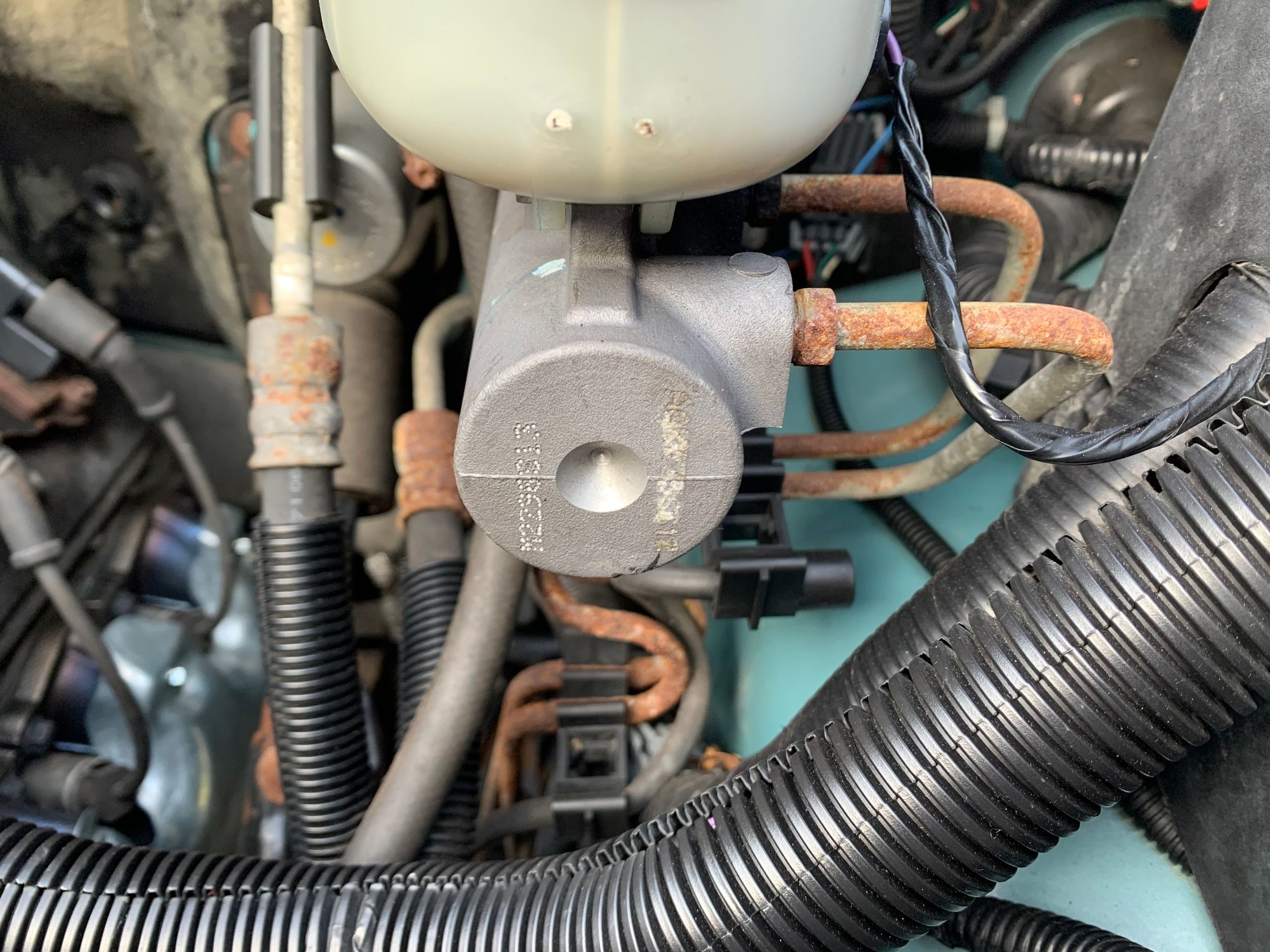

Here are 2 pics from of the engine, one is of the rusted brake lines and the other is of the passenger side of the engine showing the rusted header that needs replacing sometime. The other side was just replaced by the dealer before I bought it.

Wheels can be re-chromed by any dependable plating shop if they do wheels (many do not). Most are done in California, as that is where chrome wheels live happily. They go to die in places that use salt or have moisture. Looks like your brake lines, etc. are corroded, which tells me the truck came from the salt belt or somewhere they use lots of salt?
A good way to minimize corrosion, is to wash the inside of the engine bay including the salty hoodliner, and pressure-wash underneath the vehicle a couple of times per year.

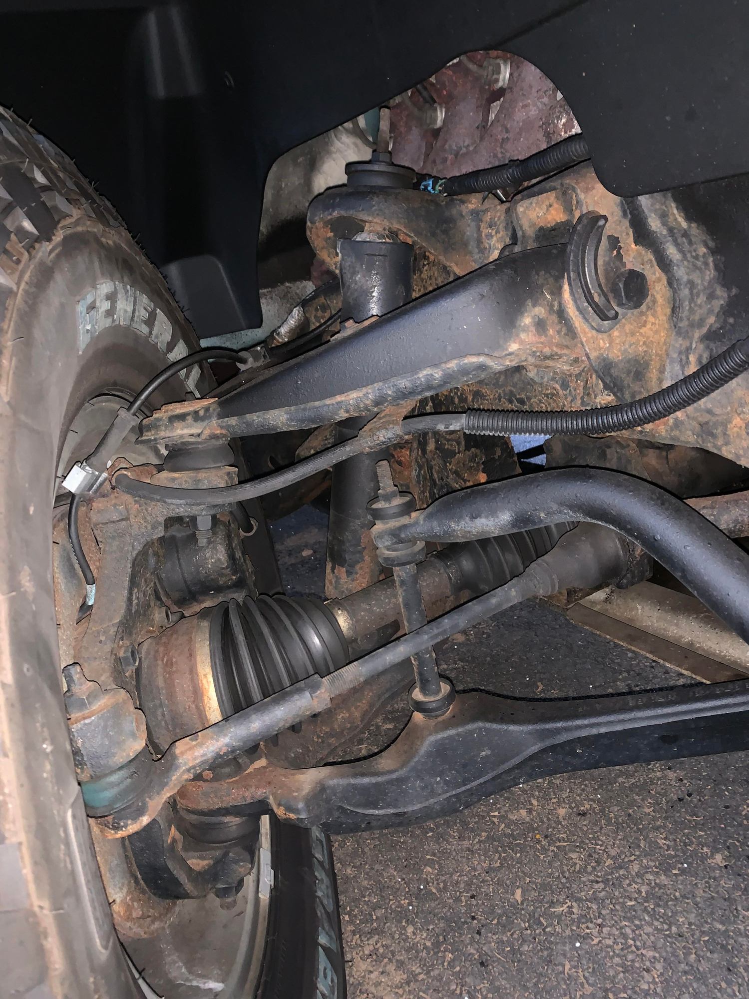

Thanks for all the help. The mechanic has the hummer and is replacing the fuel pump, back brakes including the calipers, both serpentine belts and the window washer pump.

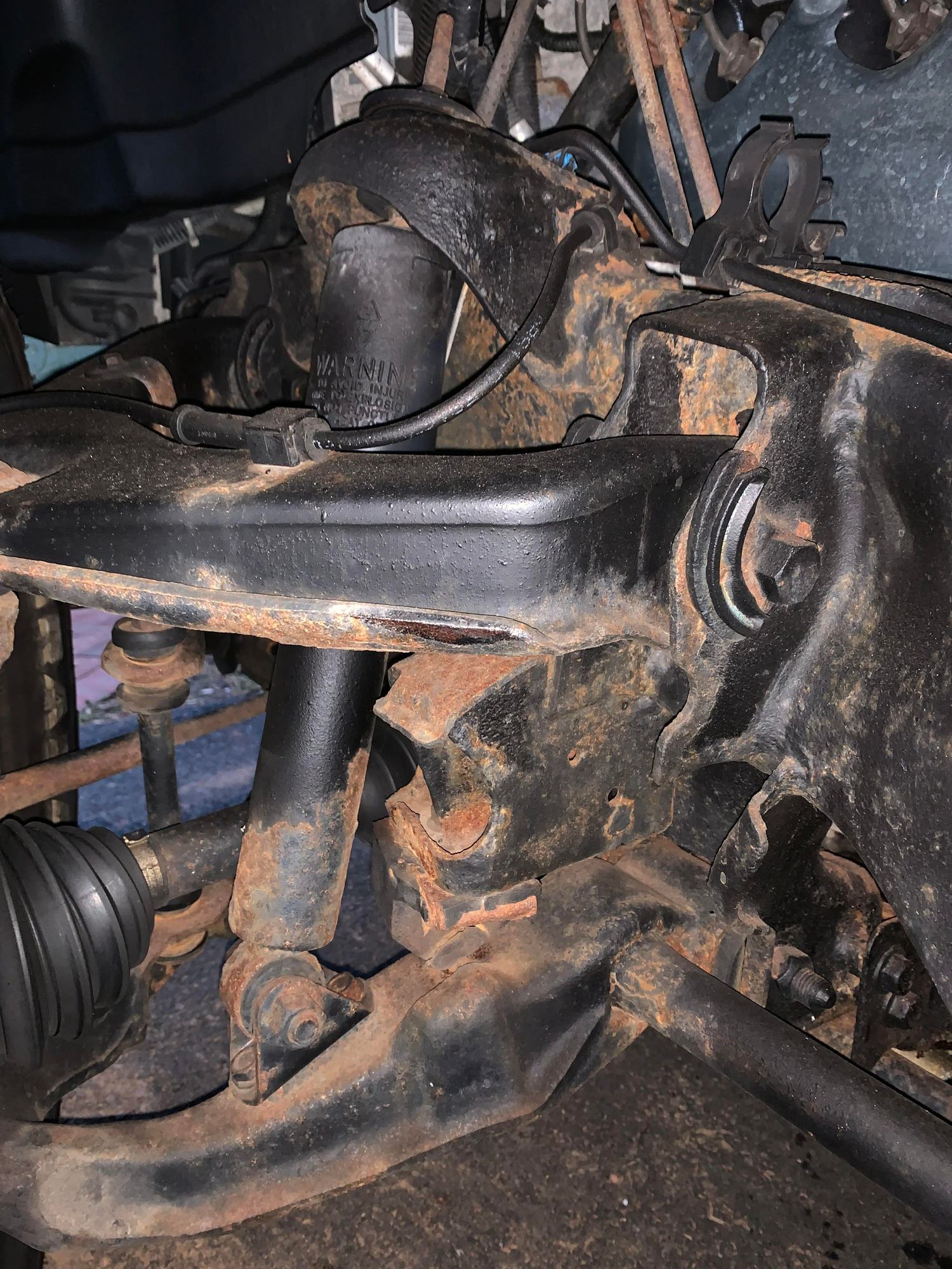

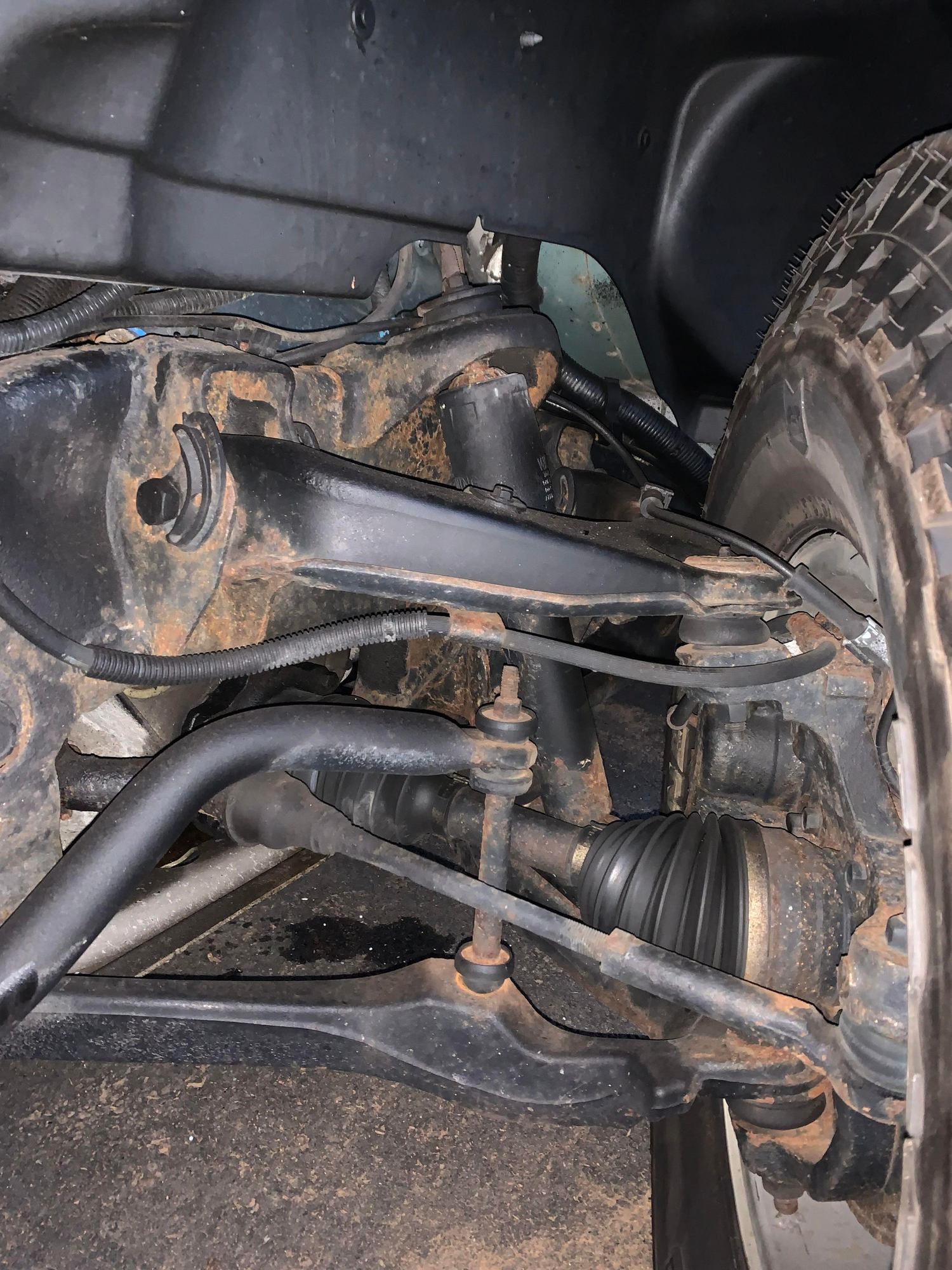

I took 2 pictures of each of the inside of the front wheel wells. Does anyone see something out of line besides the rust. Do I need suspension work or just leave it as it? Any help is appreciated.
