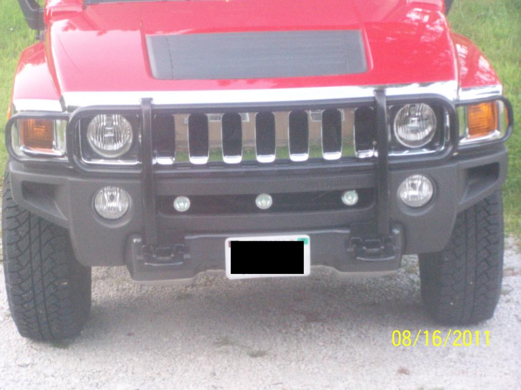

i think i bought this stuff,and more,last yr b4 snow when someone else did a similar install. i took out the lower grill,not sure what ,if any will go back. i had 4 lites,thought that would be too busy. 3 leaves a lot of space. i thought round went well with all the others.
these are, at last,an ez install.
wires tomorrow

Pretty cool! If I were you I would either trim the lower grill to fit, or maybe find some nice black mesh to put in there, it would really clean it up.

yeah im thinking of some blk mesh, not the old grill,ill save that for,"resto"

What lights are they? They are very fitting for the location that you chose. Also, how did you mount them?

walmart!, 2 in a box,i chose just 3. there are three 6 mm bolts pointing down right there.
i cut 3 1inch strips of 1/8 alum,bent apx 1 in,with a hole at ea end. a 6mm nut mounts the brkt on ea bolt and the light kit hdwe mounts the light to the bottom. so i tested the first "L" brkt,marked the lower hole,tested,redrilled to get the vert position. then made 3 finals.
its a pretty quik fix, need to run the kit wires ,,soon!
oh,an xtra nut not needed from the light kit fit the existing bolts,,cool.
$= appx 40 for 2 sets

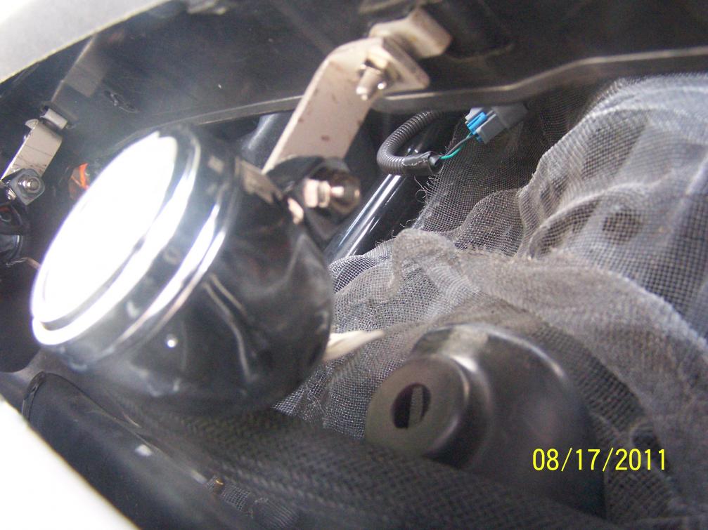

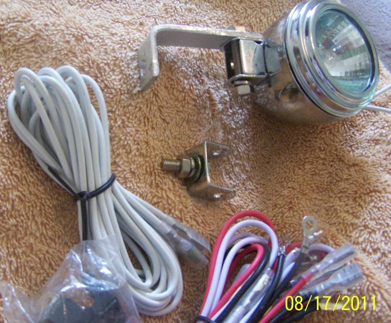

lite kit pic shows old swivel,new bracket
install cant get ez er,lites installed.
and like hunner says,keep ure nuts tite!
wires next
