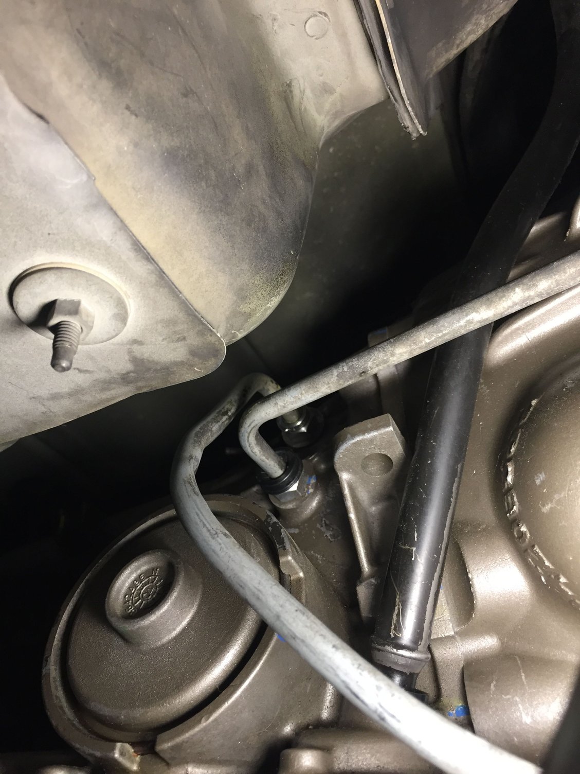

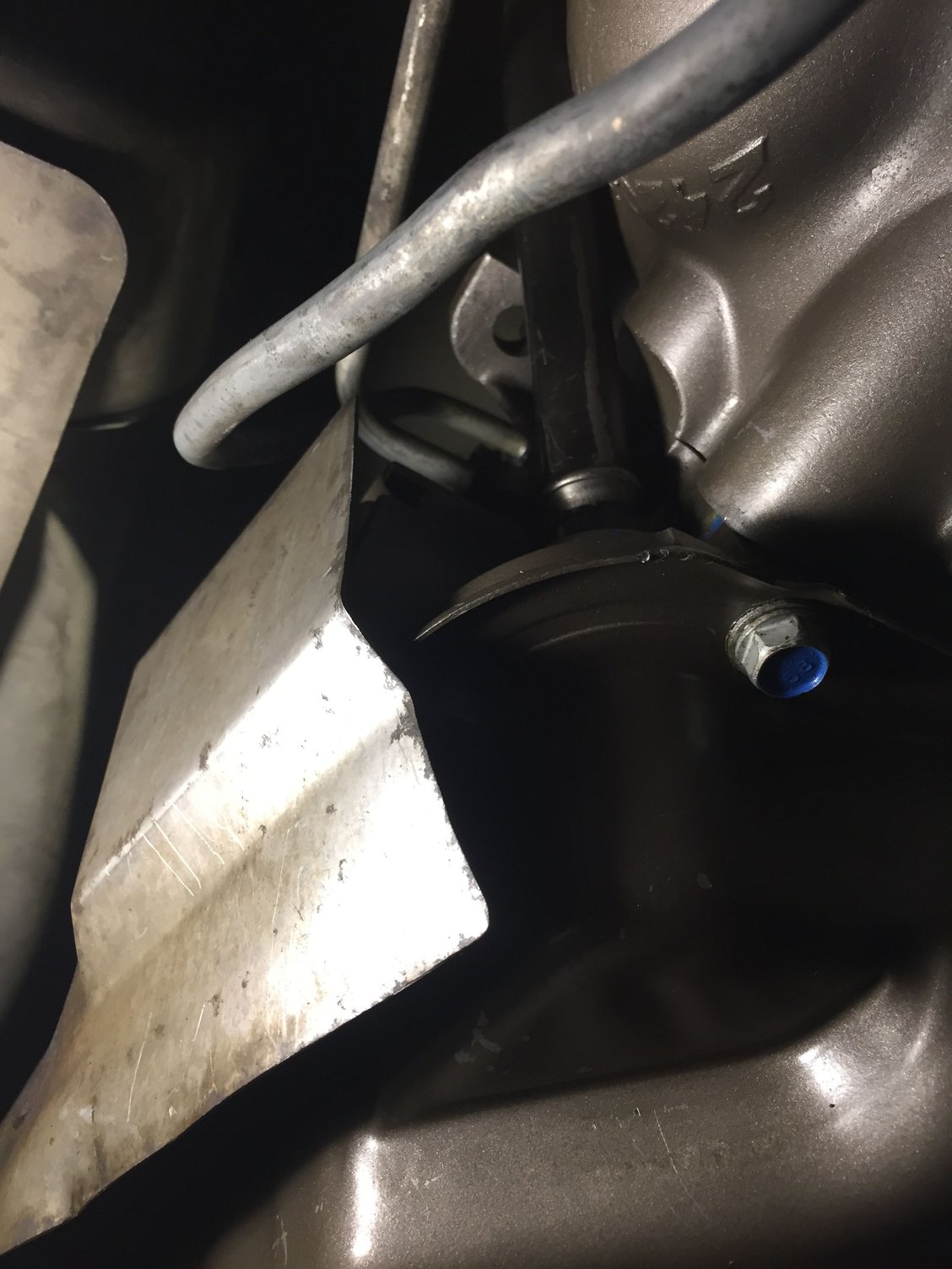

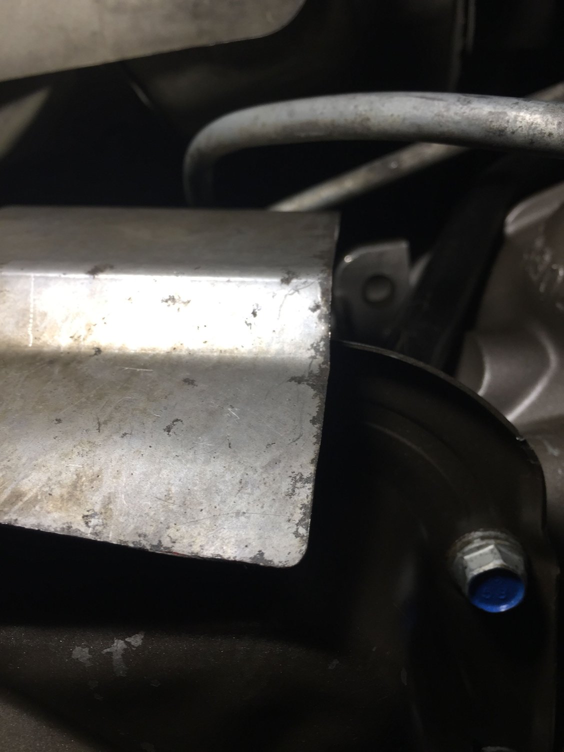

Here is the heat shield on the passenger side of the transmission. Getting the cooler lines to not bump it/hit it was a challenge.
This shows how close I got the cooler line to the heat shield. Initially, I routed the cooler lines without the trans heat shield installed. Didn’t work....had to reroute the lines
Another angle....cooler line barely missinig the heat shield
Close up of heat shield and cooler line

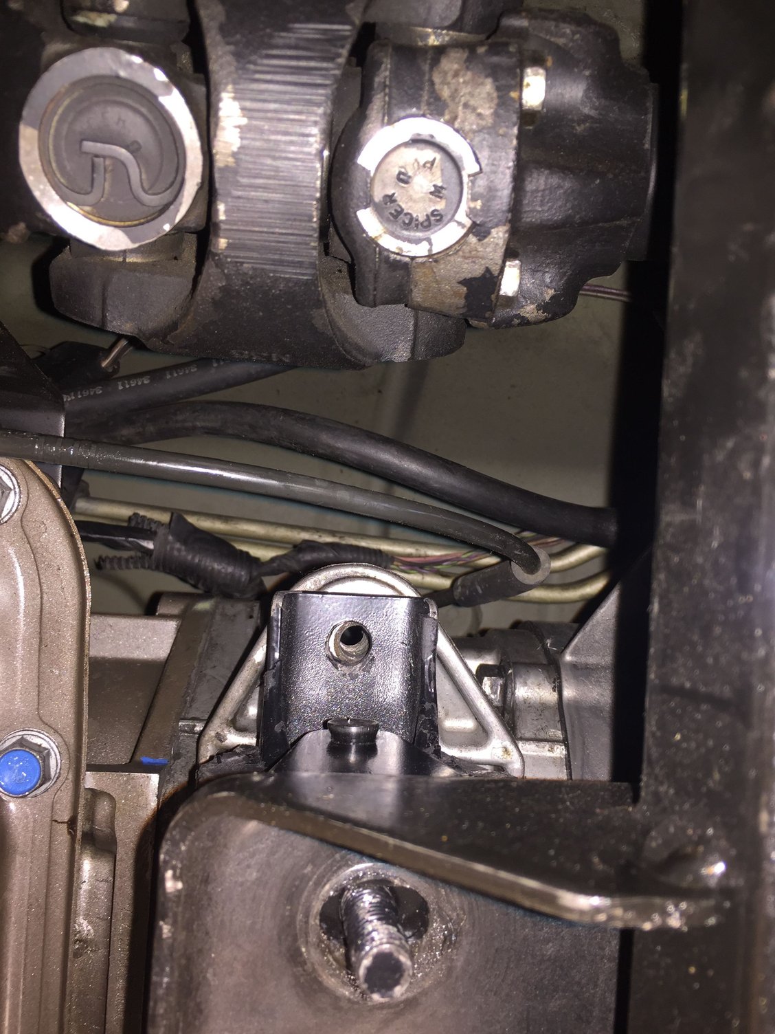

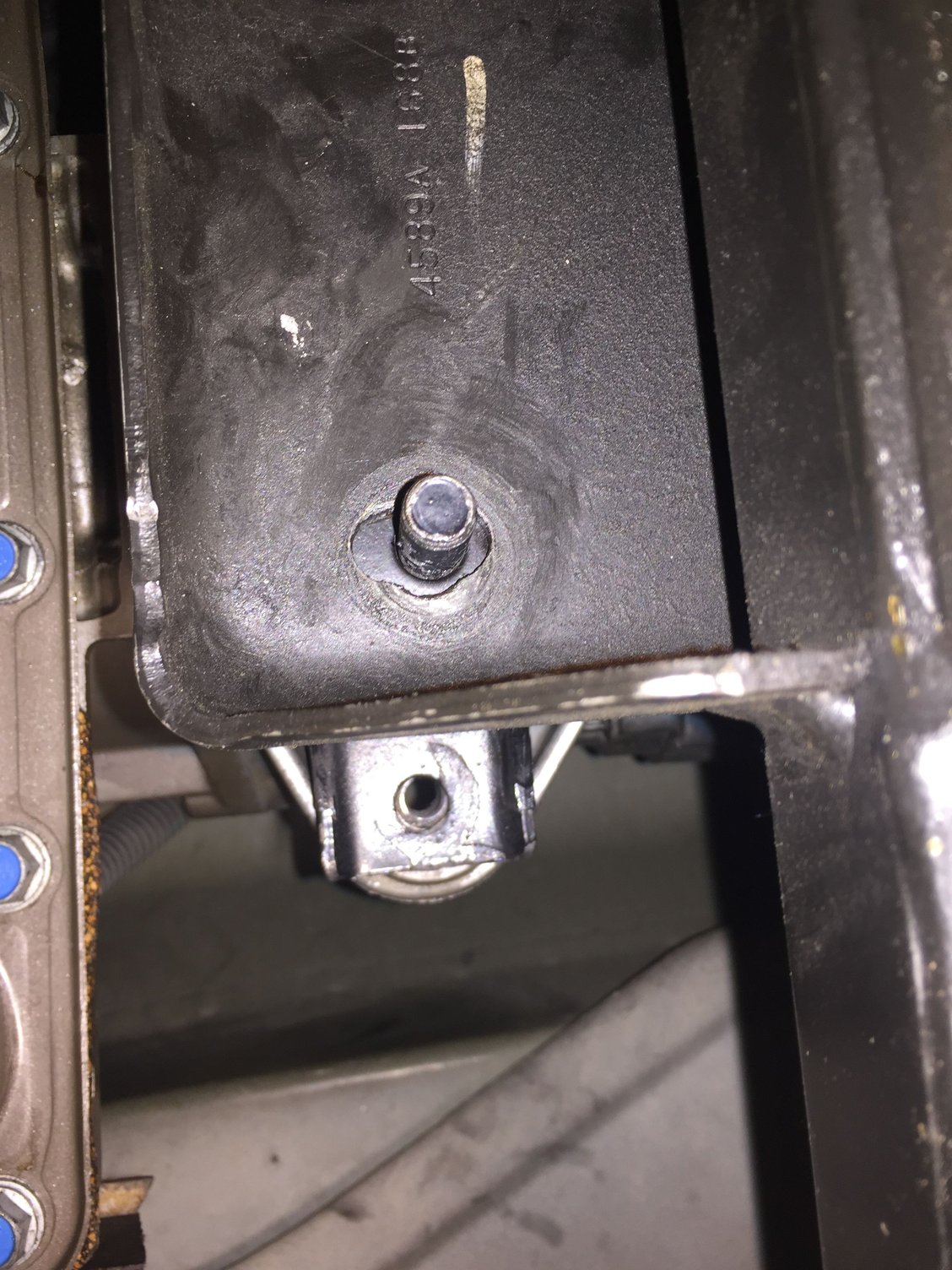

Took a pic of the hole alignment on the trans mount
Old Jun 11, 2018 | 07:58 PM
  #44
RoH2's Avatar
Joined: Oct 2016
Posts: 176
From: Texas
Trans mount hole alignment

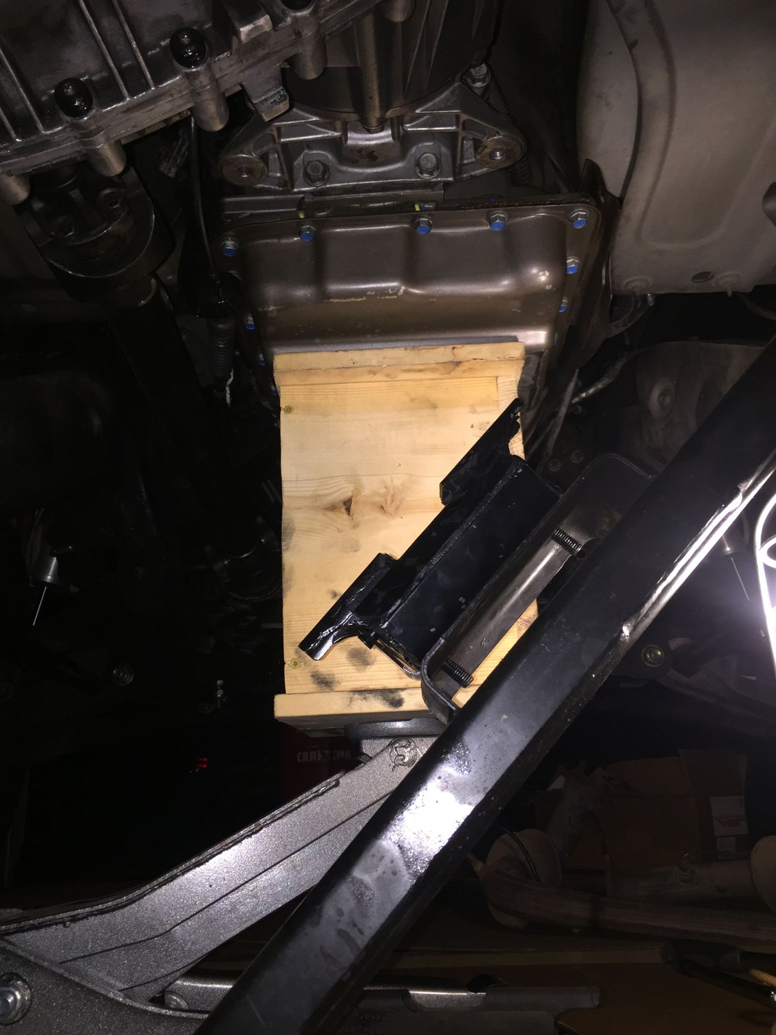

Dropped the crossmember holding trans up.
Used the wooden box in background to hold up transmission while I dropped cross member.

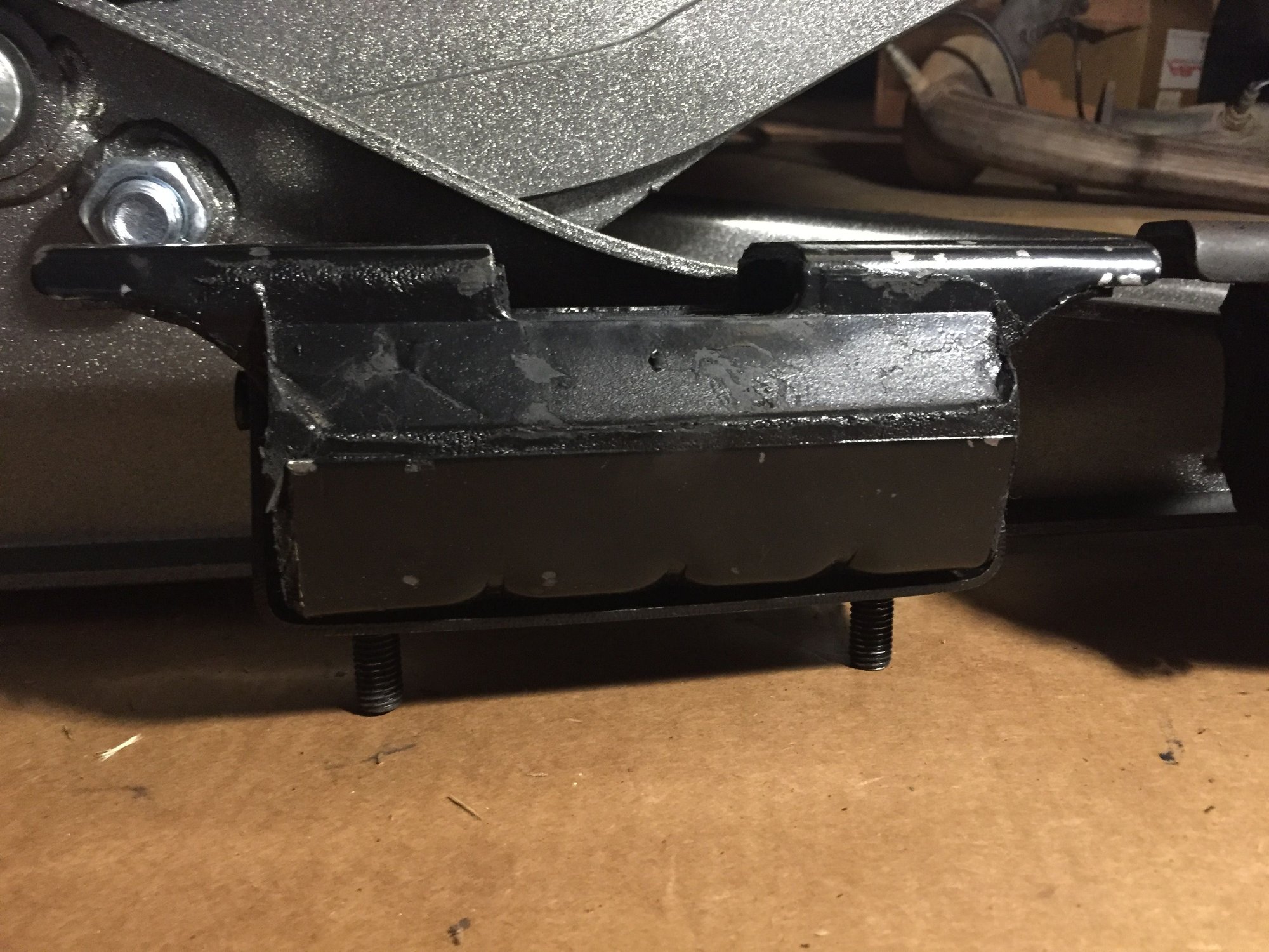

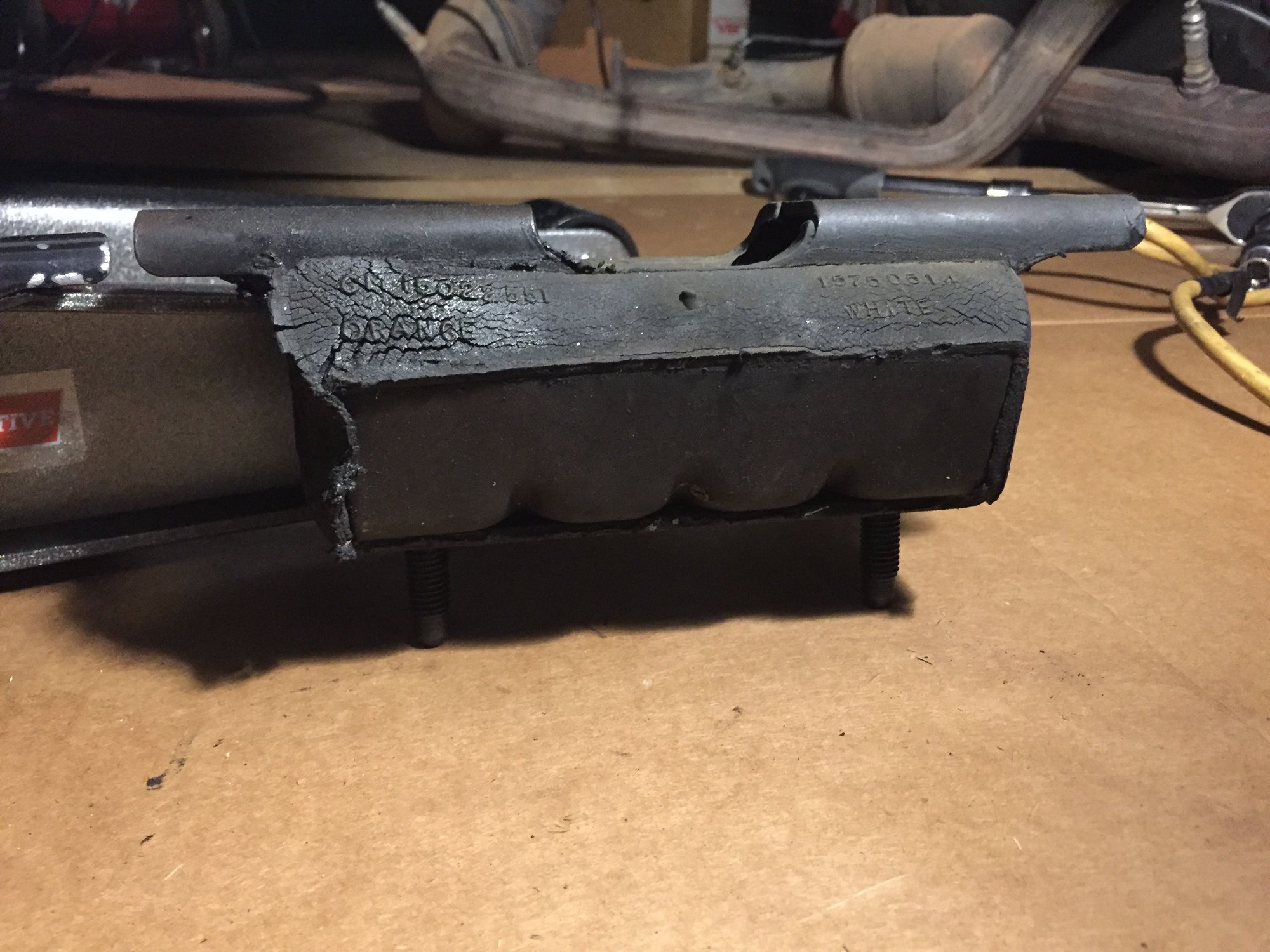

Comparison pic....(left side) new vs old (right side)
Old trans mount
New trans mount

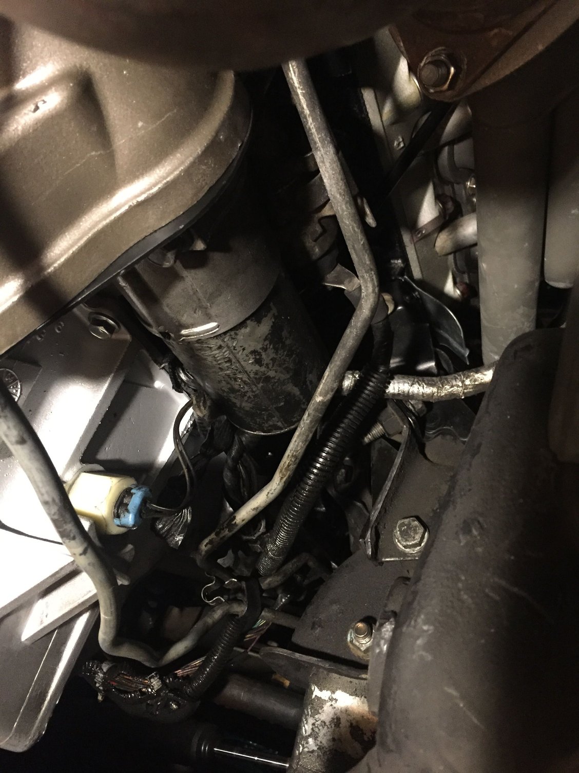

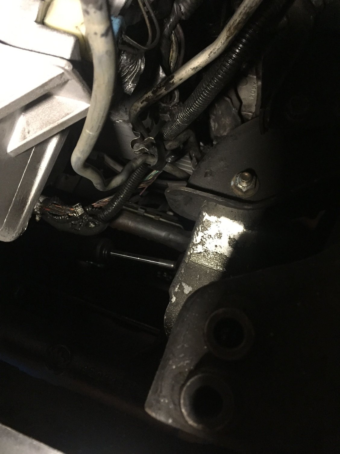

This shows trans cooler lines from back to front. Also has the catalytic converter installed to show proximity.
This picture shows the “center” section of the cooler lines....the black metal bracket

Another pic of the black center bracket
Trying to capture both lines from trans toward front of vehicle
