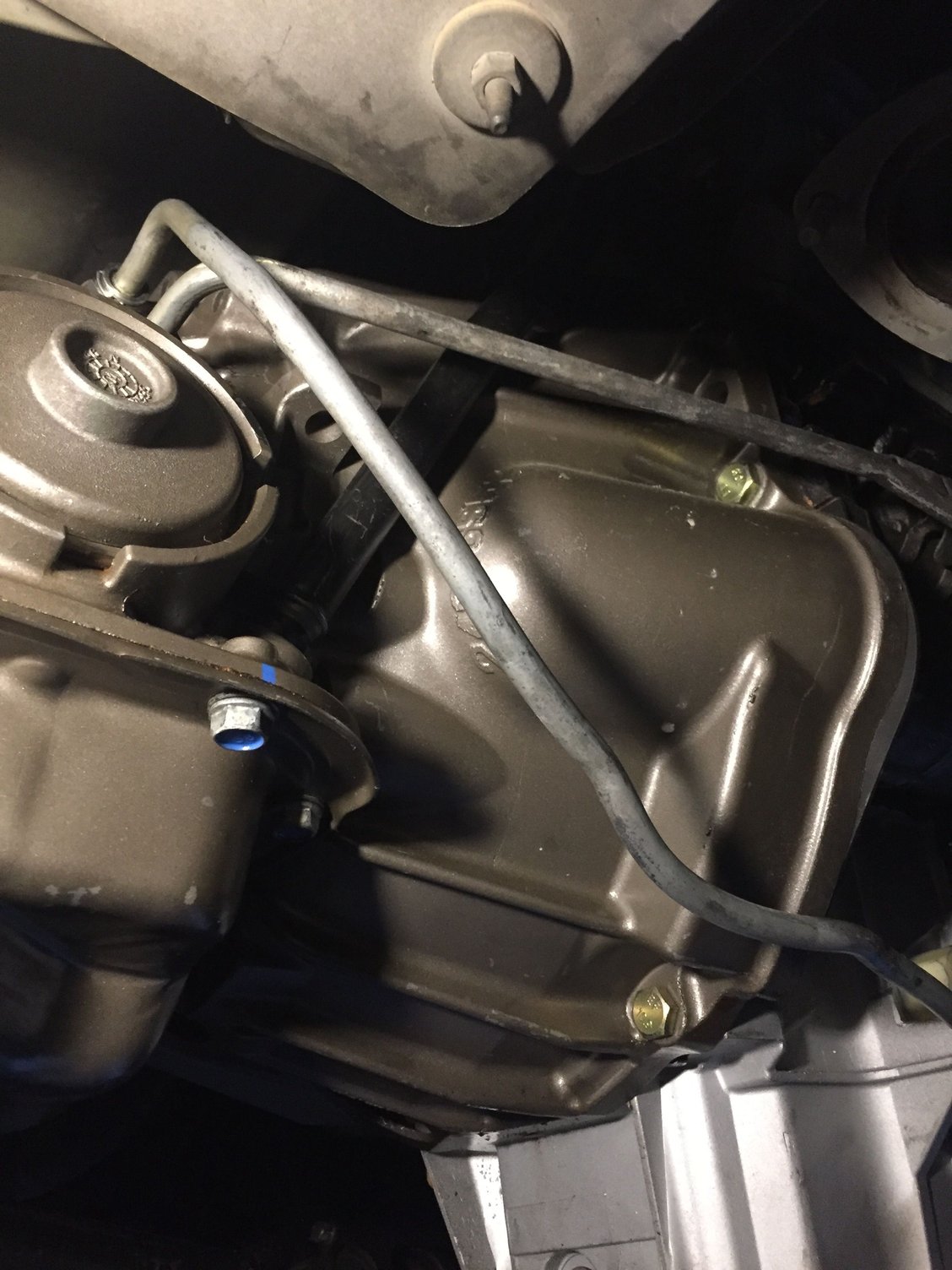

This is the trans cooler lines connected to the actual transmission
A different view to show the way I routed the lines
Another angled showing line routing
