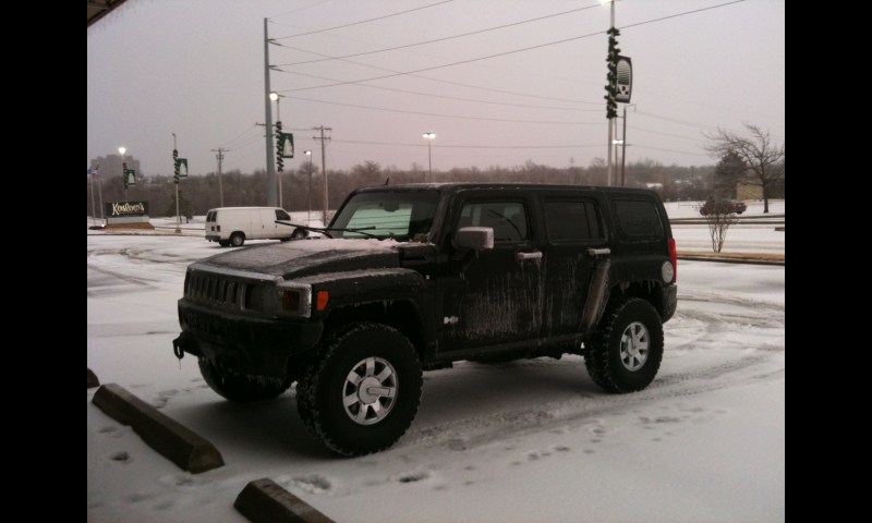

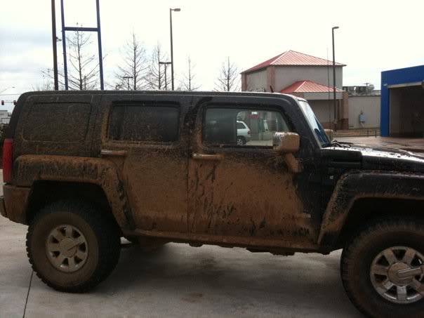

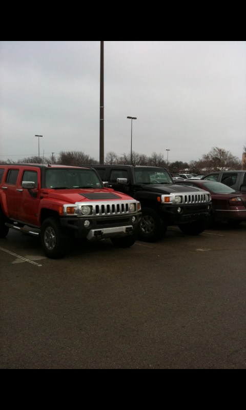

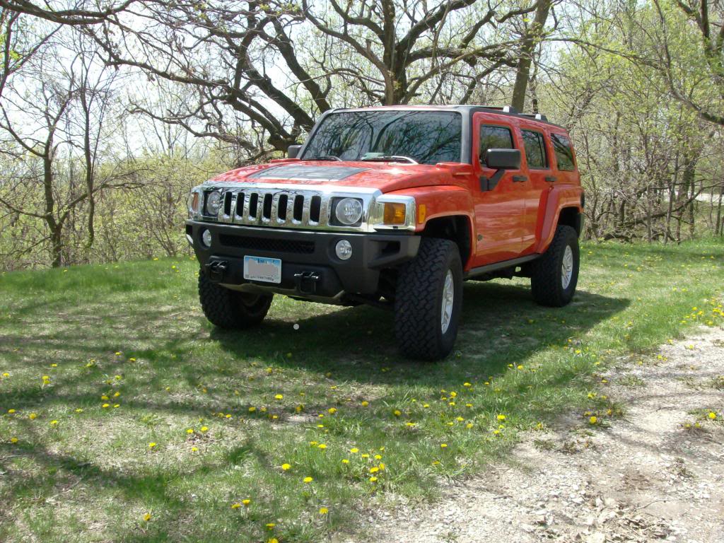

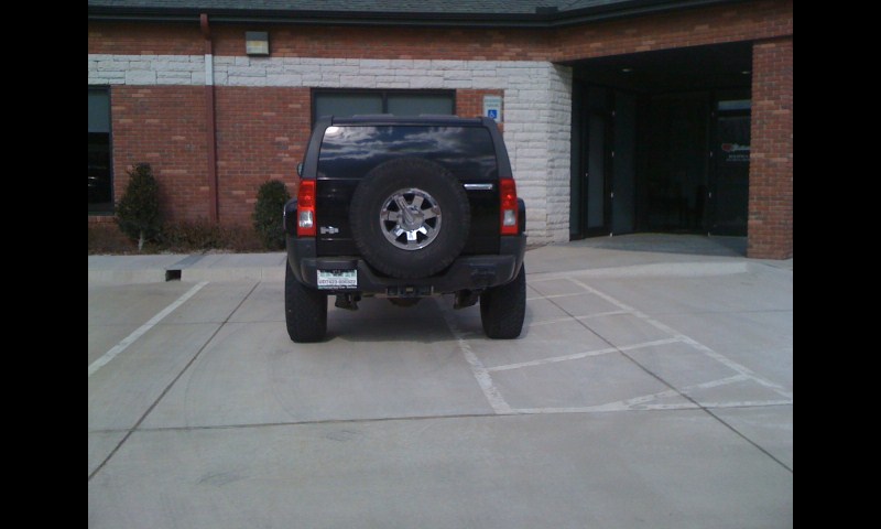

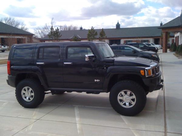

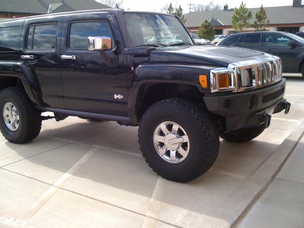

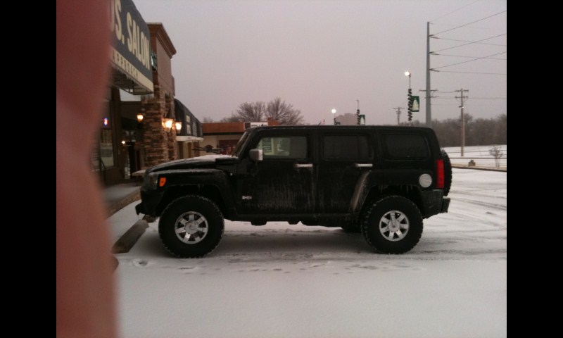

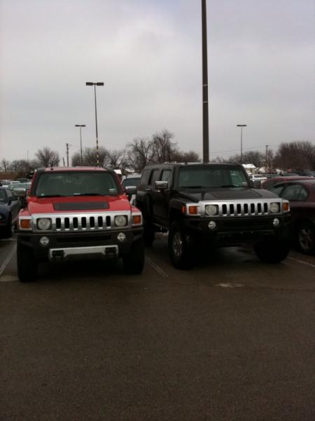

what 35" BFG's will look like, and leveled
not my H3 btw, I just admire what this owner did

If you want around a 35" tire then you want to go with a 315/75R16 they are between 34.2"-35.1" tall.
The PCM tune is in no way mandatory after you swap to larger meats. But, the nice people at pcmforless.com will adjust your Speedo output to reflect the proper MPH for the tire size you have chosen.
DAIs are. Nice addition to the I5 motor. In combination with the PCM tune you may be back to just about the stock power you felt before the addition of the 315s.
Hope this helps

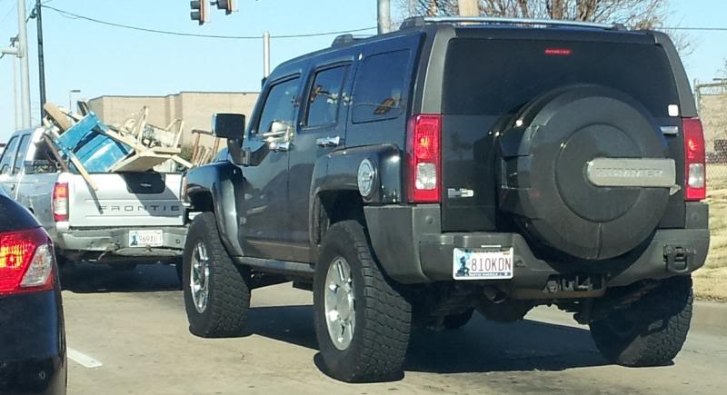

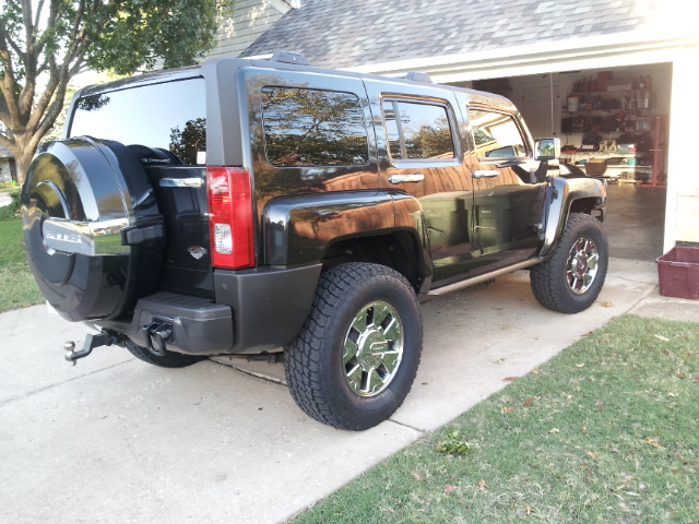

Thanks Manson! I know this is an old thread but I just saw it. I sold that H3 a couple years ago, but missed it so bad I bought another one (H3x Alpha this time). Here are some pics of the new one (I think I perfected the stance on this one 295/70/18s, aka 34.4's, with the front leveled to 23.25" hub to fender).

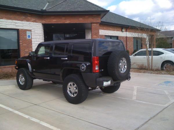

And, here are some more of the old one, in case you haven't seen them:
Size:  55.6 KBName:  IMG_0530_zps7707ef72.jpg
Size:  53.9 KBName:  IMG_0528_zps0e200bbb.jpg
Size:  60.3 KBName:  IMG_0498_zpsd47dc796.jpg
