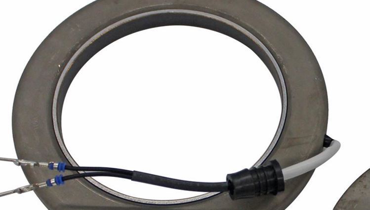

Does anyone know where the grommet that goes into the diff for the rear locker can be found? Mine was rotted and broke into pieces and I need a new one.

No part # for the rubber grommet.
It comes with the Eaton E-locker as an assembly.
Find a grommet that fits and drill a small hole to pass the 2 wires through.
It looks like this
